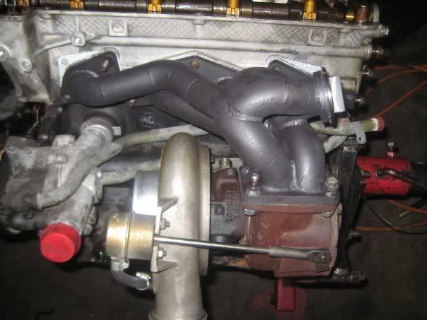

The plan was to clean it up a bit, weld the internal wastegate flapper shut to use an external, and have it mounted to the beautiful piece that came from "Reindeer Performance" in Finland, thanks to Vigge:

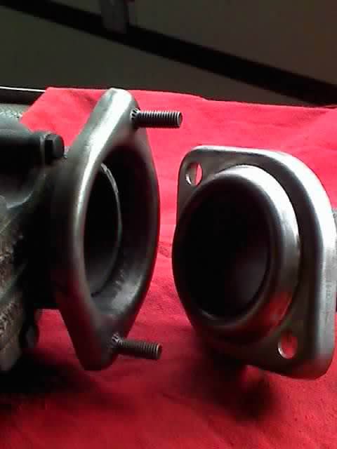

Other changes will be of course a Walbro 255, injectors - to either Siemens deka 630cc's or the new 1000cc's from the same series that just came out - , and a JZW tune. Another thing is modifying the exhaust to work. The HX35 comes with a v-band outlet but my dad wanted to try something else so in the end it'll connect like this:
No issues with sealing, no clearance issues, just simple and clean. It's 3" and I still have a 3" 90 degree stainless pipe for the other flange to be welded onto. As you can also see, my dad cleaned up the compressor housing a bit when he had a minute so that's a nice cosmetic fix.

Small update. I'm back and settled in now, so we're getting started on the new downpipe. We're gonna make it but have someone else weld it..my dad has a really nice welder but doesn't trust his skills enough for something like this so yeah..anyways!
FINALLY more of these flanges were listed on ebay so I picked one up. $20
3/8" mild steel
Of course that's gonna be cut down a bit, I had just bought it at the time. Will be working on it all this week if time permits for both me and my dad..also, I have some v-band flanges that are in the mail. They're just so much easier.
The 9-3 transmission that's in the above picture will also be going in my car, along with the hydraulic clutch :D
#36 · (Edited)
Small update - only parts left to buy are injectors and fuel pump. Injectors I don't need quite yet, fuel pump can be bought locally.
It seems like the only thing that's really stopping this from really taking the plunge forward is the oil lines not being here yet and the exhaust not being 100% completed. As of now, a motor/tranny is hanging in the on a chain from the ceiling and we've worked out as much as the exhaust as we can, from that. Also, still trying to come up with the best cooling fan solution; most likely just buy a 12" slim fan and make some kind of shroud.
In other words, it shouldn't be too long before having the hardware on the car. Trying to document any unusual quirks along the way for anyone else who cares in the future.
My bad managed this when I was at work one day. Not bad considering I remember paying $35 for all the metal used for this downpipe - a u-bend and a 90*. Makes me wish we made the my exhaust before, and also makes we wish I bought 3.5" pipe. What the eff would I do without my dad?
