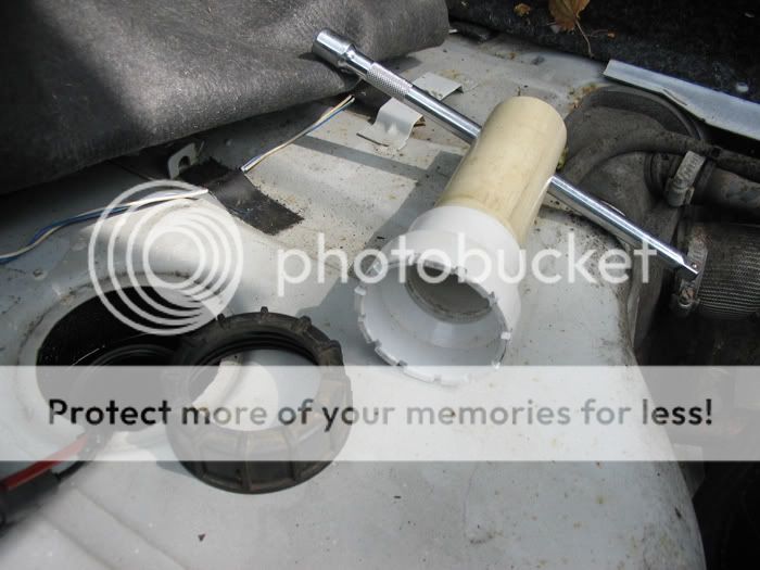

Here's what I made to get the fuel-sending unit out of my c900. I used a 1.5"-2" pvc reducer, a length of pipe and a 3/8" ratchet extension. I cut the appropriate notches with a Dremel. (thanks aireeca for the idea).

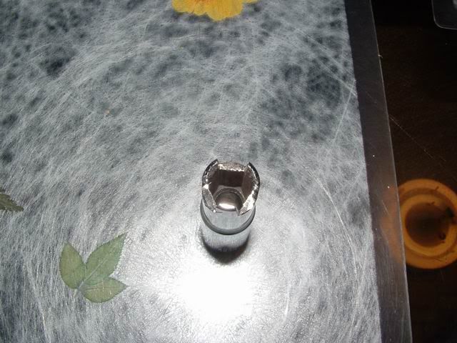

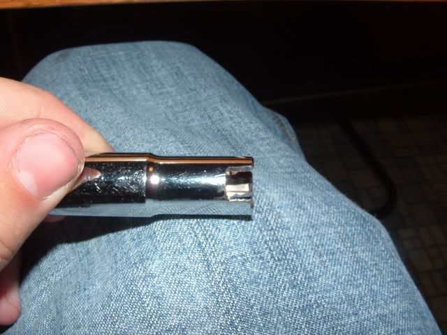

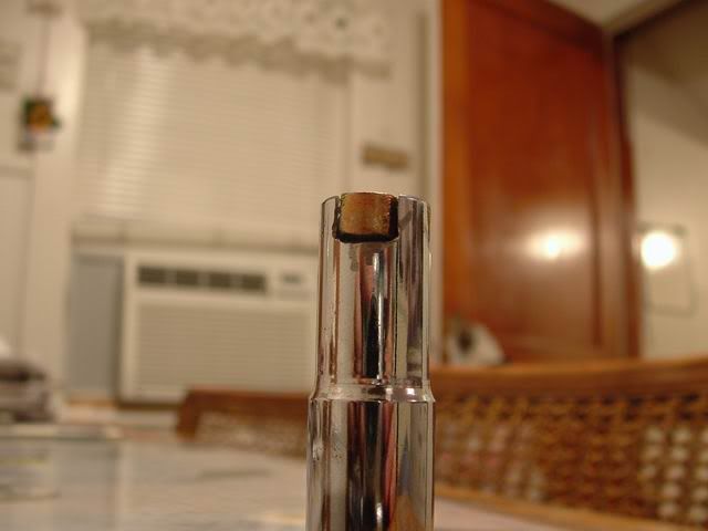

I also made this to install the Bilstein shocks on my c900. It's a socket that fits the double-D fitting on the top end of the shock shaft. I couldn't find one at all 6 local places I tried. I made it from a 3/8"-1/4" reducer socket. I cut the 1/4" barb off, drilled a hole, then used small square and round files to make the shape match what was on the end of the shock. Beats the hell out of trying to use a small wrench on them in the confined spaces underhood.

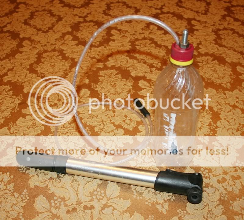

Another budget home-made improvised tool. For reverse-bleeding a clutch.
20 oz soda bottle
length of clear vinyl tubing
1/4" bolt and nut
Bike pump
clothespin
To make:
I put the 1/4" bolt through the bottle cap, and then drilled a hole down the center of it to make a valve stem to connect the bike pump to. I drilled another hole in the cap to snugly fit the vinyl tube through. The tube needs to reach the bottom of the bottle. Make sure you don't put the bolt head too close to the inside edge of the cap. You need to leave room for the bottle top. Added an old piece of APC solenoid vac line to the end of the tube to fit the bleeder fitting on the slave cylinder snugly.
To use:
Have a clothespin handy. Put brake fluid in the bottle. Connect the bike pump to the valve stem. Blow a little air through the valve to make the fluid fill the hose to the end, then pinch it off near the end with a clothespin. Connect the hose to the bleeder fitting on the slave. Take the clothespin off. Take the cap off the brake fluid reservoir. Open the bleeder valve on the slave, and pump some more air into the bottle. The pressure will force the fluid out the tubing and through the clutch hydraulic system. Watch for bubbles coming up into the brake fluid reservoir. When no more come up, close the bleeder valve, disconnect the bike pump to relieve pressure, put the clothespin back on the end of the tube and then disconnect it from the bleeder fitting. Make sure that you have enough fluid in the bottle before you start or you'll blow air into the system.

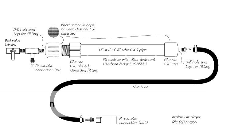

Not just a SAAB tool, but I thought this was an appropriate place to put this. I've been having some issues with wet air when sandblasting with my compressor so I made myself a portable in-line air dryer. I was using those little ones, but they get used up too quick. Parts were inexpensive and it works great. Used it for hours before having to change out the desiccant. I'm using the silica desiccant from Harbour Freight. A bag will fill it about 3 times. You can bake the used-up desiccant and then reuse it too.
