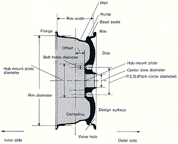

1. No, not any 4-lug wheel will work on a 9k. You need something with a 4x108 bolt pattern, 65.x center bore and correct offset depending upon wheel width. I don't think you'll be able to fit anything wider then 7.5" in there without rubbing issues. I've got 17x7.5" Ronal RTs which are 35 offset and 73mm (?) bore, 4x108 bolt pattern. The center bore and offset are fixed by using hubcentric rings/spacers. I use 8mm thick ones on my car and have no vibration from the wheels, nor do I have any rubbing.

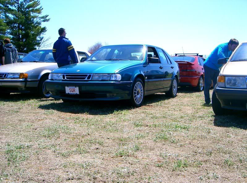

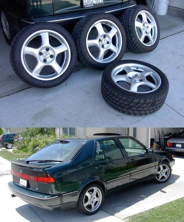

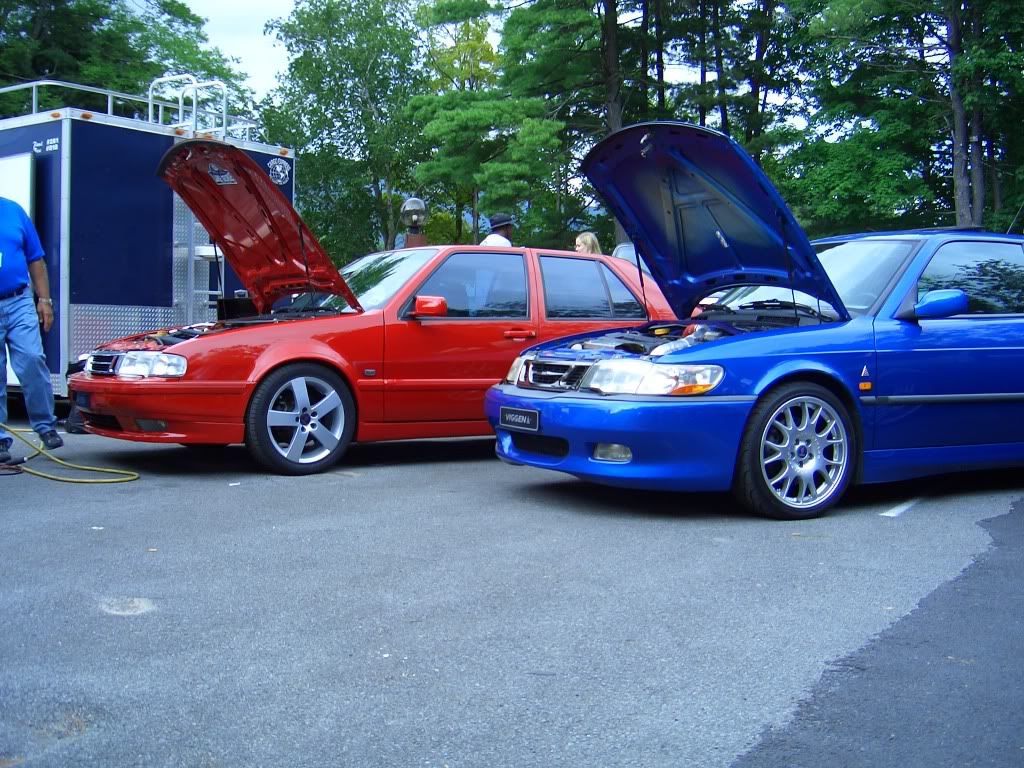

More pics as promised:
Mike Poore's 94 Aero (unsure of wheel type)
My former 95 CSE w/17x7.5" Ronal RTs
93 Aero w/17x7" ROH ZS
9k w/17" Fondmetal 9a's
...and the car everyone loves...black 9k w/18" BBS CH's

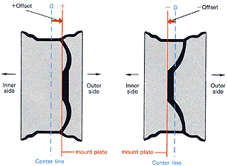

My Ronals are 17x7.5" stamped et35 and I use 8mm spacers = 27mm total offset. I really don't think you could go with anything much higher because the inside lip of the rim barely clears the trailing arm on the rear suspension. If you were to go with too thick a spacer/not enough offset the outer edge would then be a problem and you'd rub on the fender or the fender arch. 225/45/17 tires fit with no issues on my car (which is dropped).
Just make sure that you get wheels with the correct hub bore (65.1mm) or buy hubcentric rings if the wheels are a larger bore. If you install wheels with too large a centerbore and no rings, you'll get horrible vibration because the wheel won't truly be centered...it'll feel like your car is on square wheels. If you get a smaller bore wheel you'll never even get them on the car. Lots of other 4x108 cars use the smaller bore (Merc. Cougar, etc). Just make sure you check out all specs on the wheel to make sure it fits the car before you plunk down a lot of money and then get stuck with 4 expensive paperweights.

7.5" max width....for the most part because I don't see how anything wider could ever fit. Spacers are only necessary if the wheels don't have the right offset.
