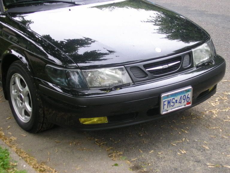

Yes.... sanding and cleaning the surface with dish soap and warm water before primer is the most important part..... My black grille on my red c900T was on there for about 25k miles (including winter driving) and it had like 1 or 2 minor chips..... not bad considering it is the most common thing to get hit with debris. Many people rush the process and their grilles are all chipped within a week... Take your time ;)
So key things to remember....
Sand with like 60 grit and scuff the thing up really good.
Soak in a bathtub of dish soap and warm water. Rinse and let dry.
Spray several light coats of primer to the grille giving plenty of drying time between each coat.
Spray a few extra layers than you would normally with the paint.... Let it cure.
Spray with a strong clear coat (I use Duplicolor High Heat Engine Clear Coat).... Spray several coats. This is what will protect the paint from rocks and give it the extra shine. Let it cure, preferably in the sun if it is the high heat stuff.... it gets very hard in the sun ;)
