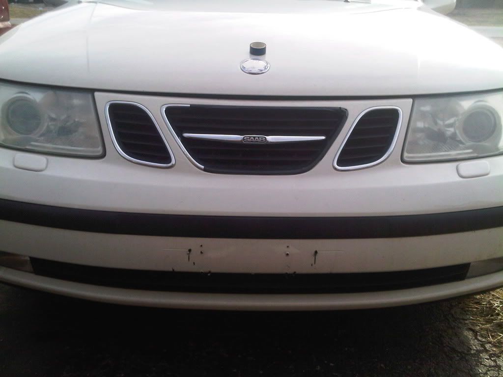

Obviously I'm not leaving it like that. haha I just put some electrical tape on it to give an idea of what I want to do. I already took the tape off.
I wanted some opinions before I break out the plasti-dip. How do you think it looks with the chrome surrounds in black? All of them not just the center one, I just didn't do the rest because it's about 25 degrees outside.

It doesn't do anything for me. The chrome doesn't either though...

Black grille might be too dark/cheap looking. I'd either leave it, do a more graphite color, black chrome, or CF wrap it. Maybe some tasteful black mesh behind any of that too. Just throwing ideas out there.
I would honestly leave the grille alone. There are not many options that will yield dramatic visible improvements. Instead of focusing on that, I would suggest you spend your time and money on a front lower lip spoiler. In my opinion, it's the only visual improvement one can make on a 2002-2005 linear/arc front-end that's doesn't cost an outrageous amount. You can go the stock, oem route, which will probably cost $100-$200 depending on condition (used vs. new), or you can go cheap (yet still nice) and go for an aftermarket, $20-$40 universal lip, something which is usually made out of flexible weather guard. There's a few threads on here about it.

And for your headlights, don't waste your money on any kits. Wetsand them with 1000, 1200, 1500, and then 2000 grade sand papers. When you're done, buff them with rubbing compound and apply some wax/sealant. They will look like new afterward.
I agree, for your car now, I would add an oem front lip you could find at a yard for cheaper and get rid of the two black pieces of plastic under the right and left side of your front bumper. I dont know what you have to spend but I'd leave the front grill chrome and black and just add a spoiler.
