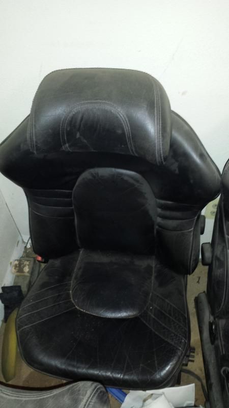

Does anyone know if the newer aero seats front and back will fit in my car
So I'm a little confused about something? I did some digging and some say you can't or shouldn't change the gearbox fluid on a 91' can anyone give me some insight? Maybe a little how to. The 91' is getting some work done next weekend. The gearbox fluid is something I want to do ASAP.
People say that if it's never been done on a high mileage car, don't fool with it. But I'm pretty sure that pertains to automatics with filters and valve bodies. I see no reason why you shouldn't do it. Just do a quick search and verify the correct fluid you should use.
The Aero interior will swap no issue.

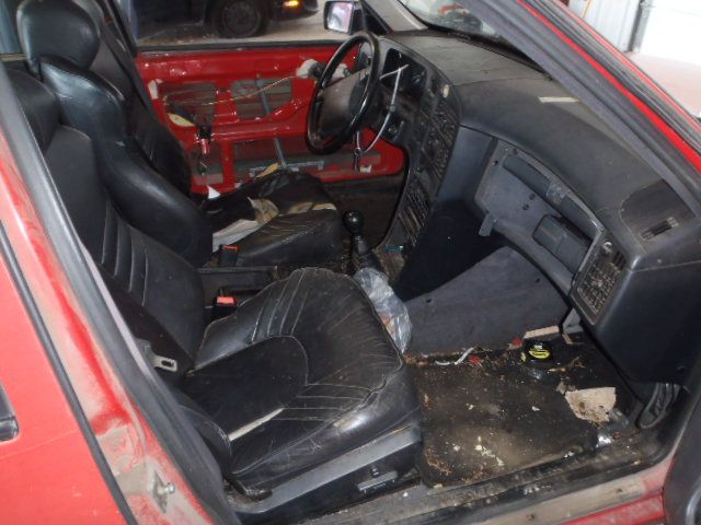

The interior needs to be cleaned, but this is what it looked like when I Picked it up
