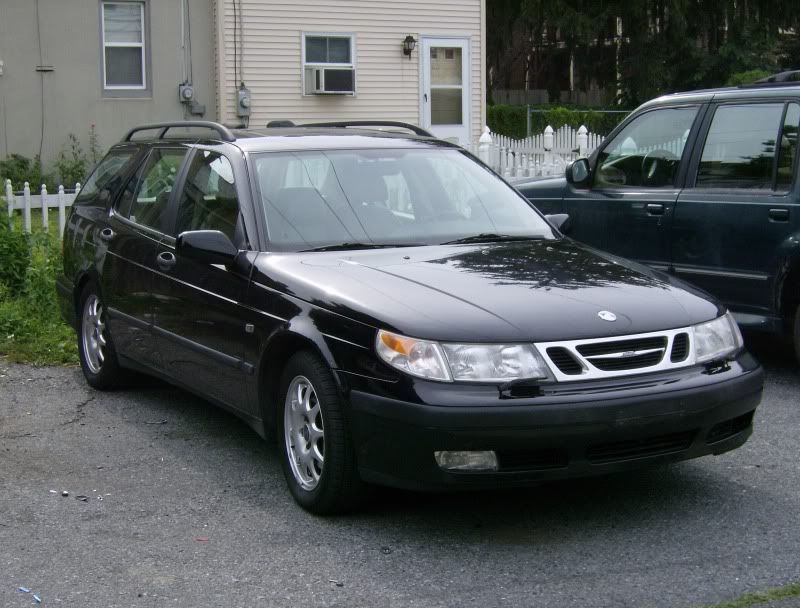

Hi, I know I've been around for some time, but now I'm stepping into a whole new ball game with the 9-5. What I got is a 2000 2.3t wagon 5speed with 82,000 miles. I would like to learn all that I can, the quirks, its cool features and what I can do with it. Also what to have upgraded or what to look for, what to carry with me on my daily drives & long distance drives.

I ran the VIN against several checks & the NADA VIN check came back that the wagon was a Gary Fisher Edition, I did research on what a GFE had, there isn't one feature on this wagon that would backup that it is a GFE. Any ideas why that would come up GFE?
yeah, doesent look like a GFE. My understandingis that the GFE is an AERO in every way but the turbo. It still has a GT17 and LPT software.

Yeah it has a one owner history same person leased then bought it, good service records, regular mantainance & clean history.
