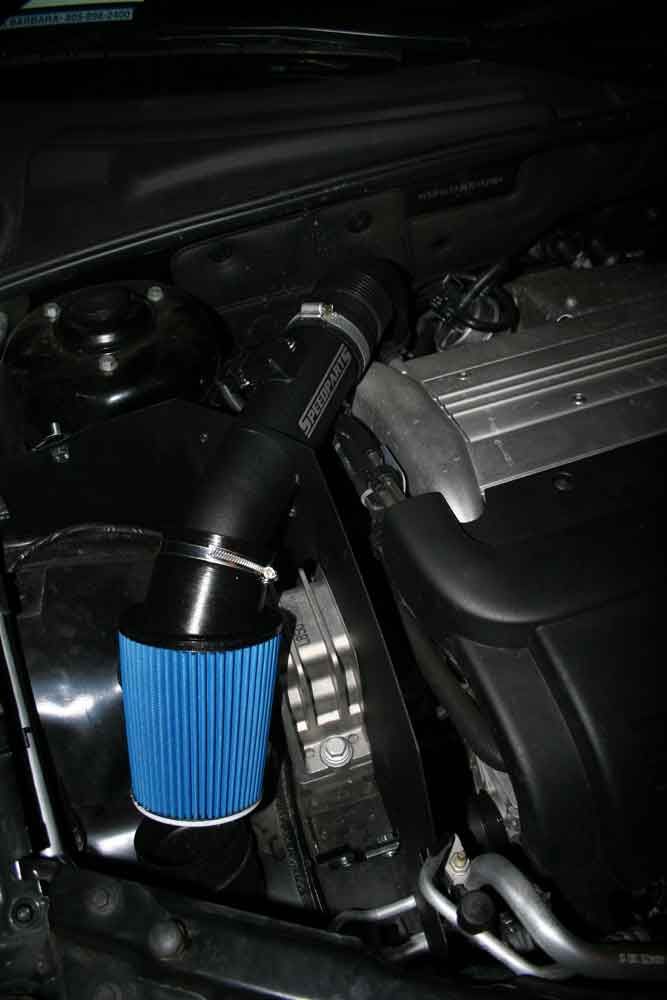

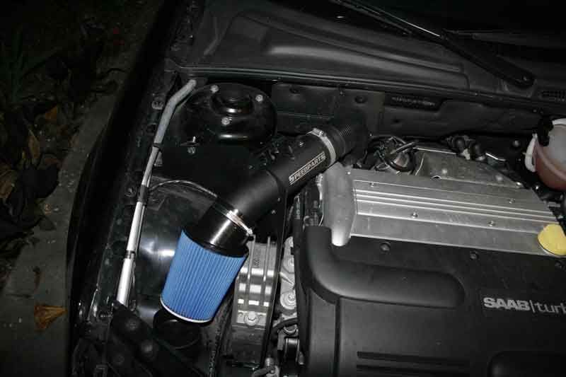

- Speed parts open air / BSR open air (same as speed parts basically): This product was removed due to problems in the high RPM range. As of my knowledge the manufacturers are still selling them, however most resellers dropped them. The bug can be fixed with a software update that most newer cars should already have, if you have a 2k3 you may need to have the software update put on. http://www.elkparts.com/product_info.php/cPath/76_160_839/products_id/1217

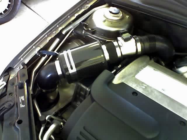

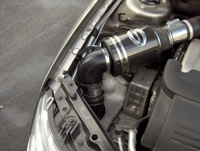

- Simota carbon fiber: Very difficult to install, poor instructions. I contacted simota and received very poor support from them. As of my knowledge I'm the only person that has it properly installed, and that's because my mechanic friends helped me out. I purchased it from PFS, it arrived in USED condition. I posted on SC about it and was BANNED. DO NOT PURCHASE THIS PRODUCT.

The diverter valve on this car is integrated into the turbo, unless you modify the turbo this can not be done (obviously). If you want the pshh noise, change the air intake. Also the part of the air intake that youre looking to modify with that "3 inch" modification wont do you much good. The air filter box has a tube goes down in front of the wheel well, and then goes to the very front by the grill, in order to pull cold air in. It's a really good set up, the only way you would improve uppon this is if you changed the entire tubing set up, meaning taking off your wheel well cover, front bumper, etc. I would only recommend changing the filter.
Notice how the Simota intake goes down in front of the wheel well, that hole is from the stock air box.
