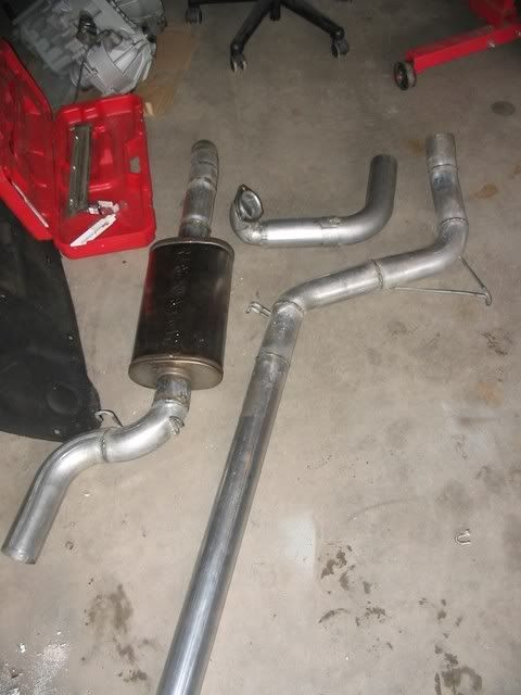

Next I bought $250 worth of 3" tube and made a 3" exhaust system (February 2006)
