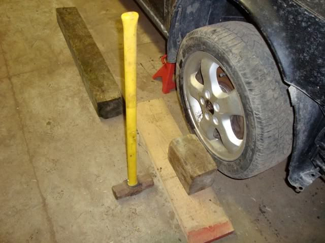

I do this:
These babies were stuck. And stuck good. Sledge - wood - rubber then rotate tire and repete. I also used a long 4x4 from the other side of the car to push the tire off the center bore. Just don't knock the car off the jack stands... Once the rim is off wire brush the hub.

Wood and a sledgehammer, keep rotating the wheel and hitting it. It will come off. You really gotta whack it
Lay the wood flat against the wheel, not the short end of the 2x4 or you may bend the wheel.
Helps to get mad first.
Yep. Do that and it'll go, eventually.
Then wire brush clean and put a thin layer of grease on it and it'll never happen again.
