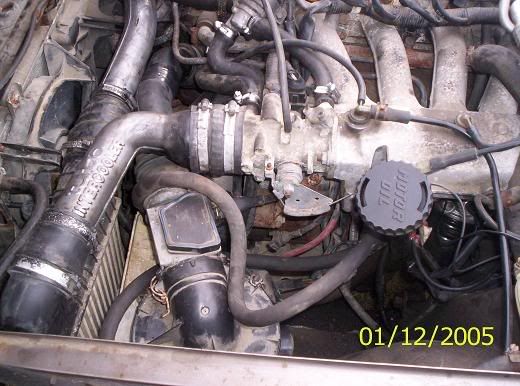

I turboed my Grey turd.
It was pretty straight forward, i installed an 85 turbo manafold, turbo, and lines, made an oil cooler (but you could get a stock one off just about any 900 turbo), threw on a boost gauge and turbo plumbing, 2.5 inch exaust and i was good to go.
i keep the boost below 8 PSI, but with the high compression pistons the car moves. It pulls like a freight train until 4500 rpms. from there it tends to lose intensity.
BTW im a senior in HS right now. when i was a sophmore i bought a 91 9000T, now its running stage 4 power. i say that because 91-92 9kts are kinda cheap now and pretty easy to aquire. not a bad idea when they start at 200hp, and my LPT might be making 145hp after all the work i put into it.

I stuffed my oil cooler right between the intercooler and stock airbox. seems to work find, the car hasnt exploded yet. i took it on a 250 mile round trip last weekend and it never missed a beat.

i turboed the NA in 6 hours...... but i had access to a lift, torch and welder, and 12,000 dollars worth of matco tools:)
so far its been fine, but i suppose it goes on a case by case basis.
keep in mind this car was bought for 50 dollars, sat for 3 years, and fired up immediately, and i have been driving it for the last month and a half.
