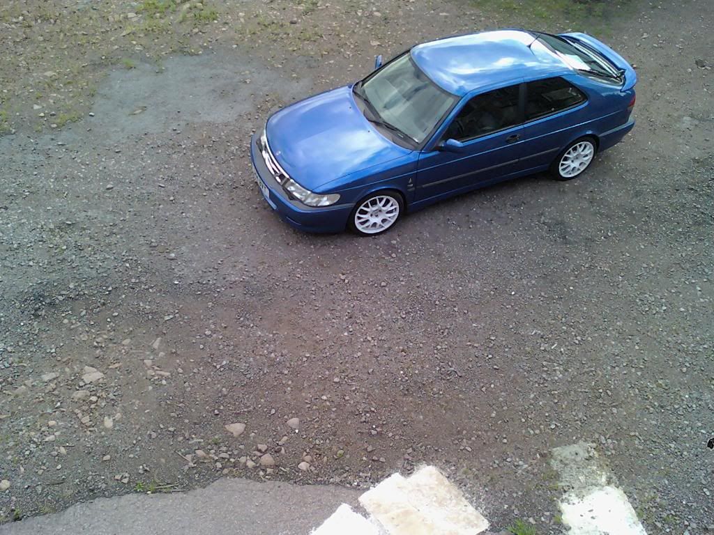

For sale is my SAAB 9-3 Viggen coupe.
Its a 1999 model in blue with blue/black leather interior.
Its taxed unitil April 2011 and has mot untill jan 2011.
This car is my pride and joy, i have owned it for 3.5 years and it has been cared for to a very high standard.
The car currently has 107k on the clock but has been totally rebuilt mechanicaly since ive owned it from 91k.
The engine was fully rebuilt at 94k with a b234r (9000 aero) bottom end and the orginal b235r (viggen) top end.
This combo was choosen for the strength of the older engine but with the better and more modern cylinder head and ancilaries.
While apart i also had the crankshaft lightened and balanced, removed and blanked off the balancer shaft chain drive and fitted a lightened Abbott racing billet flywheel. The result is a nice responsive engine that revs very freely but with a small increase in vibration.
The engine has always been run on fully synth oil and never uses a drop. I have just serviced the car with new 5w40 oil and saab filter ready for the new owner.
The engine was also fitted with the latest revision of breather kit, a part often overlooked and know to cause problems if not updated.
Not long after the engine rebuild the gearbox gave up so was replaced with a lower millage unit and a quaiffe atb diff fitted at the same time. the diff makes a massive differance to the drive of the car offering more grip and increased cornering control.
As for the rest of the car its in generaly good condition apart from 3 areas the front splitter, rear bumper and leading edge of the bonnet. the front splitter hads been scuffed on both sides, the rear bumper has a scuff on the o/s where the owner before me scuffed it when reversing. the front edge of the bonnet has been sprayed by chips away and is a slightly different shade and from certain angles in certain lights if your looking for it you can just make out the differance.
the interior is very clean and tidy with just the usual wear on the drivers bolster.

Very nicely done Viggen! Good luck with your sale.
Is there even anyone on here from the UK? I saw this car on SC yesterday, very clean and amazing looking. As well as every modification was done very tastefully and improved the car as a whole. Good luck with the sale...
The right car in the wrong continent... Car looks awesome! GLWS!

the wheels are compomotive cxt's 18x8.
