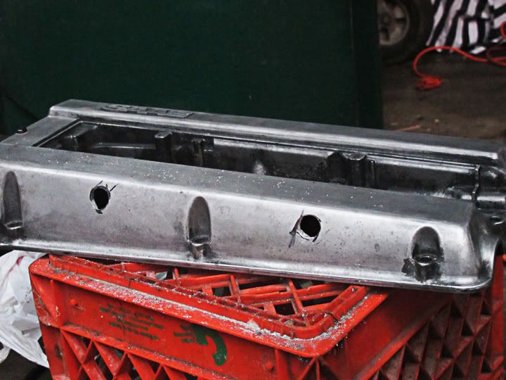

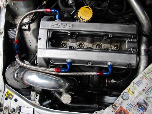

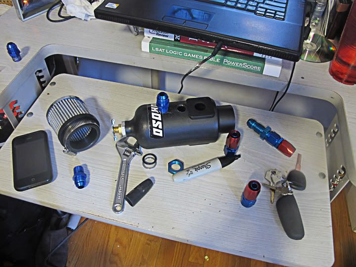

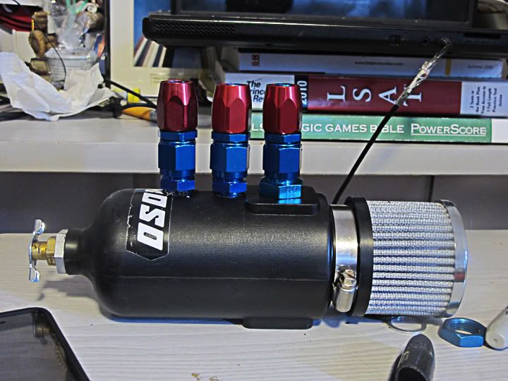

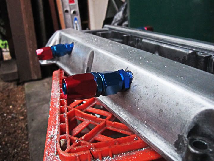

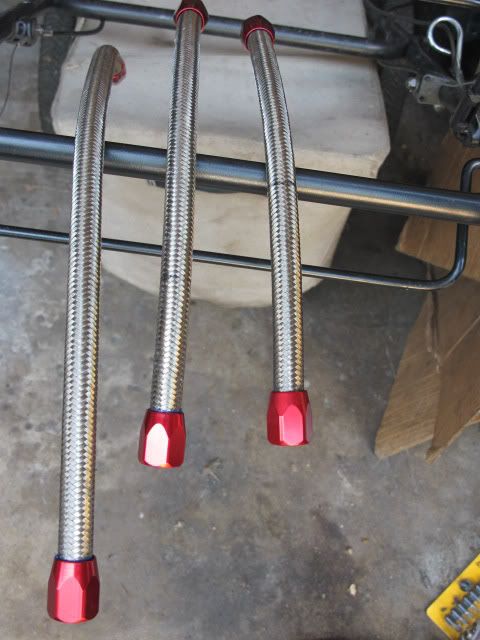

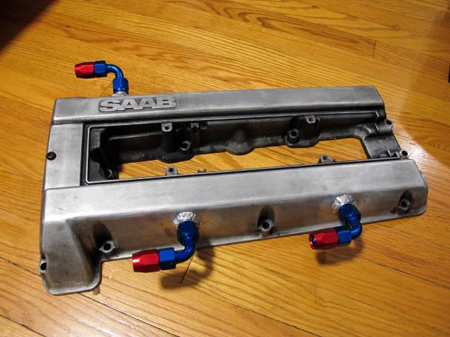

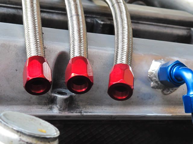

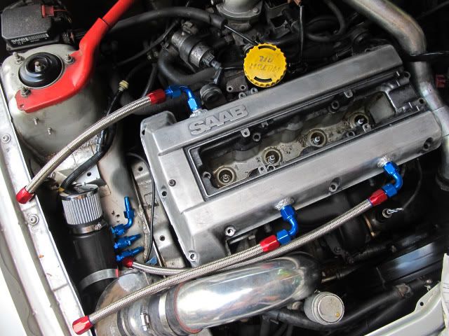

So my original catch can was collecting a some oil and thought i would help the engine breath a tad bit better by releasing pressure and drilling a few holes on the valve cover. Never seen a SAAB with AN fittings on the valve cover. Cost me $150 so far. Need to get it welded and i'm done.
V mock up of the AN Fittings. I know, the catch can is going to be much more tilted right V

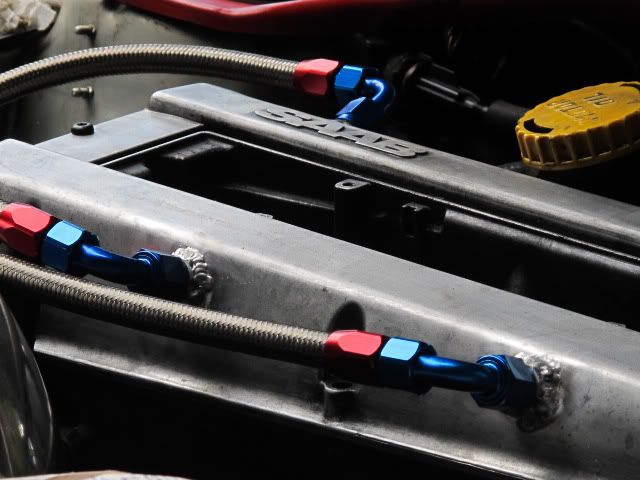

Updated pics:

2 things.

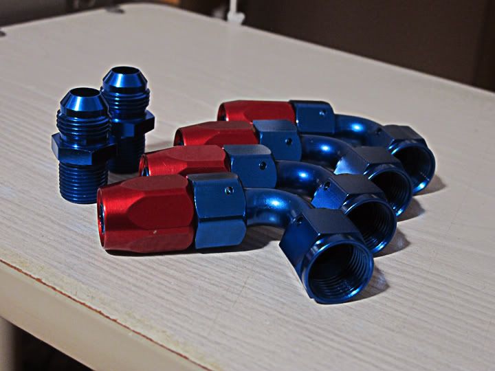

1 - the fittings you have are not the weld on type, you will need to buy the proper ones.
2 - have a picture of the underside of the valve cover by any chance? i cant recall if they are baffled, but i have a funny feeling they arent...which will pose another large issue for you.
the rear one is baffled i believe. why does it have to be baffled? Pretty sure not too much oil will get in the fittings. And my performance shop uses these on all their high hp cars. They weld on fine..?

Curious to see final result - I think 1 of those fittings would have been enough of an upgrade, why do you do when you take turns hard and the oil leaves the engine and fills the larger catch?
On a side note - isn't the catch supposed to be mounted upright - thus the drain on the bottom, not the side? Seems like all this work is going to be for nothing :(
2 things.
It is not baffled. Only the rear is where it has the 2 J shaped tubes.
Because the baffle impedes the flow of oil through the vent. If you drill just a hole the pressure will cause large amounts of oil out since it has a direct path.
you have nothing to stop oil coming out the front two hoses if it is not baffled. i would use a clear reinforced hose so you can see how much, as i have a feeling its going to be a problem.
earls fittings makes specific weld on bungs.

And I will be adding a baffle when I have time. Car won't be driven any time soon since I'm still looking for a replacement turbo.
Instead of welding, why not tap the valve cover and use thread-in fittings?
i went to pep boys, sears, and any other place, they dont sell taping kits lol. That was my first plan, but no one seems to sell them so the next best thing is to weld them on.
If you are going to run it that way you need to make some changes. At least swap to a t7 oil pan /or/ weld a return fitting down low but above oil level. Run this to the drain on the can and mount the can vertical on the firewall. You could also drop it into the dipstick. (Easier is to use all the factory oil separator from the T7 cars and be done.)
Venting from the end cover works better. Also a super simple one is to machine an adaptor and use the "distributor hole"
Or go to a junk yard, buy a valve cover without the holes and go back to stock.;)

the method works thats not the issue, the issue is his plan is not very good.
BULL - I KNOW they all sell tap/dye kits! Could have bought a used MAC/MATCO/SNAP-ON from e-bay too....
they only sell a tap if he bought a non ridiculous size.
this plan was just not thought out.
ie - using screw in fittings to weld (which no shops around here will do), when they sell weld on bungs.
