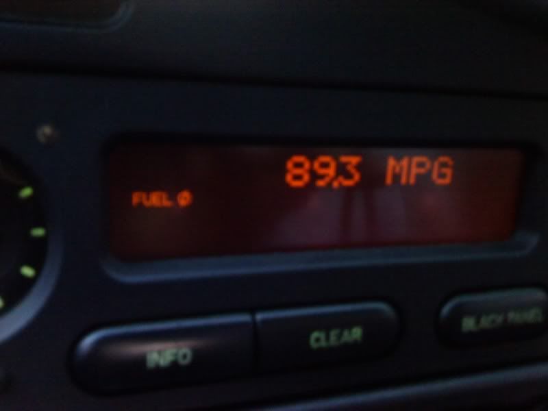

Don't believe what the SID tells you. My readout on my 9k tells me I AVERAGE 36 mpg - when I calculated the average consumption over that same time (5 fill ups) I got 30. Also, my Viggen is reading 24 mpg combined and I calculated it at over 29 during that same period. In my book that's a significant error. I do mostly highway, both are currently stock and Viggen is barely broken in after rebuild.
2,347 Posts
My SID says I'm getting 58mpg but I think it's a little less ;-)
