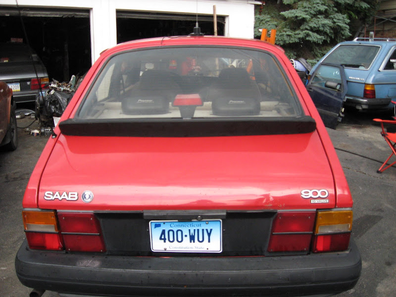

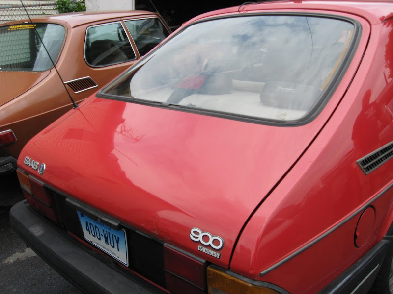

Any base c900 purists should probably stop reading right here, but, I'm sorry, I was tired of seeing that shaved hamster back, naked look on Li'l Red.
Comme ça:

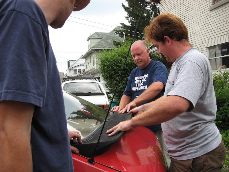

There was a little extra time this afternoon at the Plymouth Saab compound, so Jeff, Paul and Bullseye decided to do something about that hatch sitch. Easiest way to know where to drill? Daub the screw holes with some grease and then sit the spoiler on the hatch....
And then press....

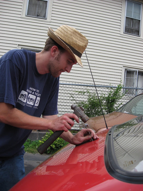

Remove spoiler, then tap the grease holes with a small drill.

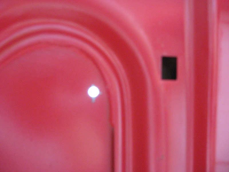

Then start drilling with a larger bit and really catch Nibbler's attention....
Ooh, sunlight through a hole in the hatch.

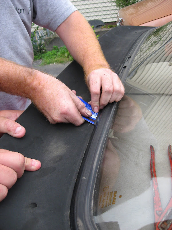

Probably the best use of credit in this crap economy - getting the edge of the spoiler under the weather stripping.
