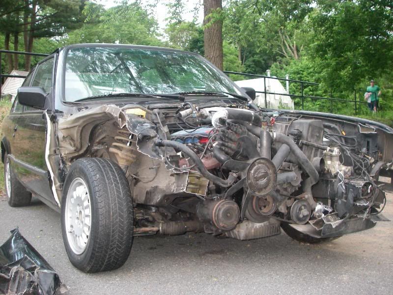

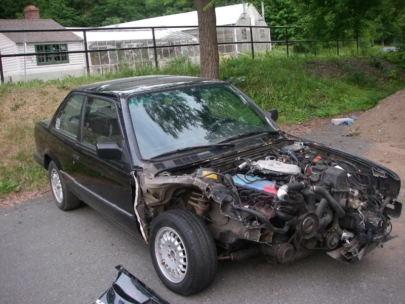

and the day my friend picked it up for me ( i was gone for the weekend) he crashed in to a tree.

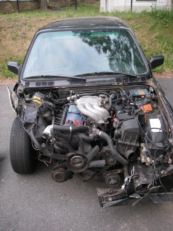

the engine is the only valuable part worth more than i paid for the whole car to some bimmer dork, and thankfully it still runs. it also has upgraded brakes fuel pump and new parts everywhere. the body/frame of this car was the weakest link. my friend bought another 325 to make up for crashing this one for 500 and we'll be combining the two in to a sweet running auto. the new one (which is on the way) is red, has been garage kept, and has less miles. we'll be swapping in this engine and building a turbocharger setup to run on Megasquirt. looking for 300 whp. on an M20 engine this shouldnt be hard.
yeah, he is used to his awd wrx. i drove the car with him in the passenger seat and i htink he got the wrong idea from the way i was driving.... our intent is to build a fun mostly track-use car and learn how to build a solid engine and use tuning software. I'd like to tune my Vig myself eventually and this should give me a good start i think.

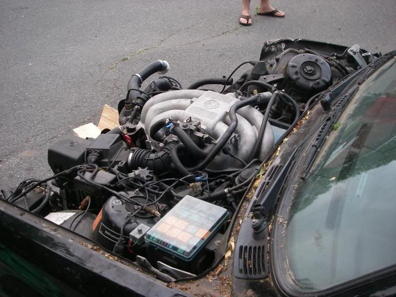

yes its the 2.7 eta with a 731 head 323 cam i intake manifold and throttle body. the car also has a walbo 255 recently put in a new heavy duty clutch new wheel bearings a short throw shifter and some fuel/timing chip
its supposed to be putting out approx 200 hp as is
Sweet engine. If your goal is 300whp I hope you are planning a whole E36 drivetrain swap (minus the engine, of course, since the M20 is fine for 300+) but the E30 diff, halfshafts, and tranny will blow up very quickly. Most E30 guys seem to think 250 or so is about the max you can run reliably through those components...my buddy and I have been working on E30's for close to 6 years now (tuned 325iX and tuned 325iS, before that a 325e) and I would say that it's the truth.
