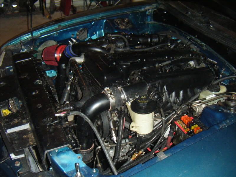

that would be interesting, Ive seen a nissan 240sx with a t5 engine from a 1997 ng900. it was a close fit, but the mounts were fabricated and it worked out well. I dont know the owner but I saw it at ics (the majority of the work was done elsewhere).
