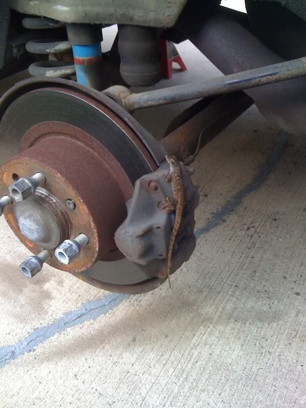

Spent some time on the racecar project this past week. Front springs cut, some interior items removed, A/C removed (except condenser) and sourced some 13" steelies with Hoosier slicks!!
13" going to fit over the brakes?
I was wondering the same thing.
Looks like I will have to shave the brakes :) my eyeball guess is no more than a 1/4 inch and I can bevel it to match the wheel shape and maintain as much structural integrity in the process. If I screw it up, then it will be time to upgrade to 88+ brakes. I will use the force with my cut-off wheel ;)
I couldn't find anything in the SCCA rule book to prevent me from installing a custom set of brake lizards!
