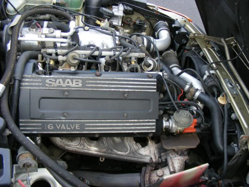

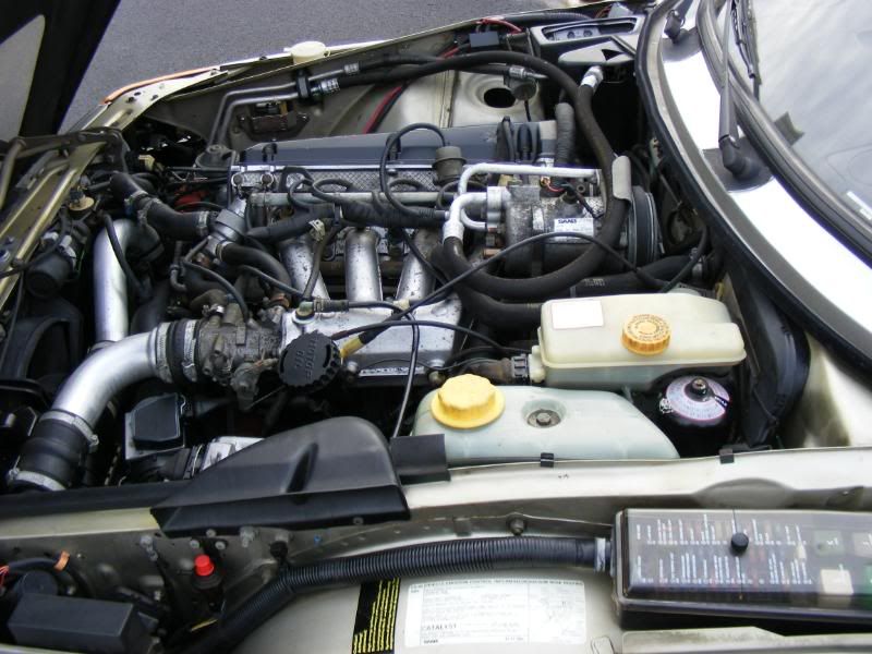

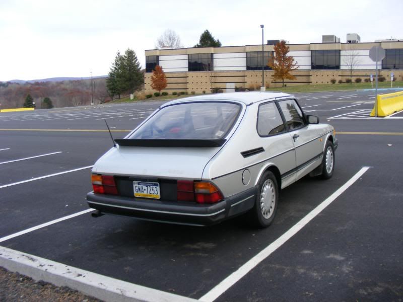

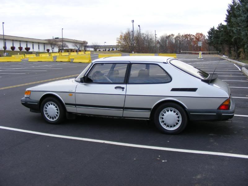

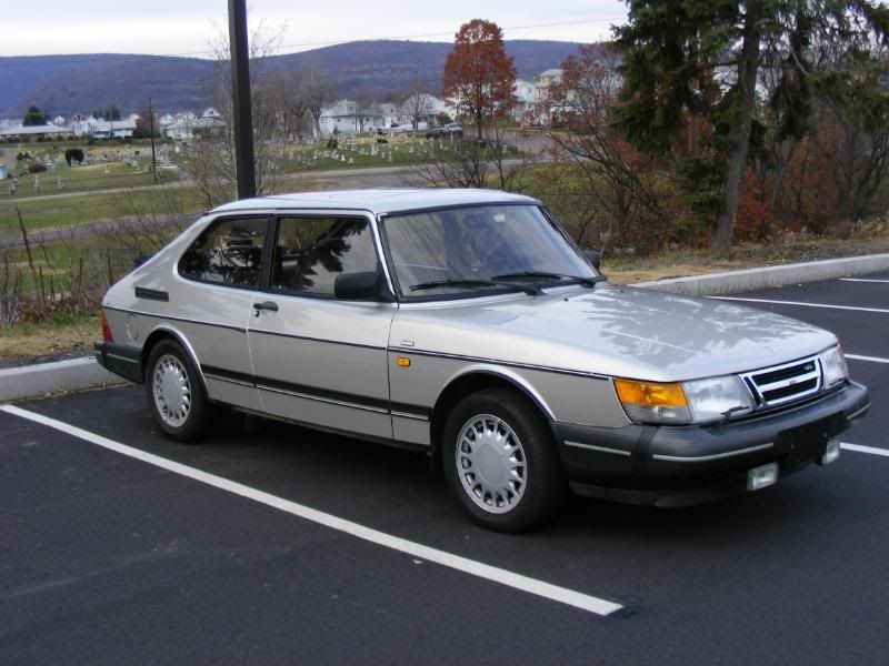

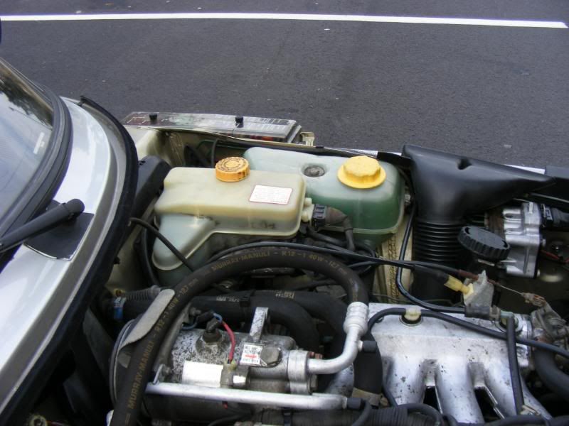

so as requested, here are the pics. the trans had been acting a little funny ever since the car has been making proper power. might soon end up being a 5 speed!

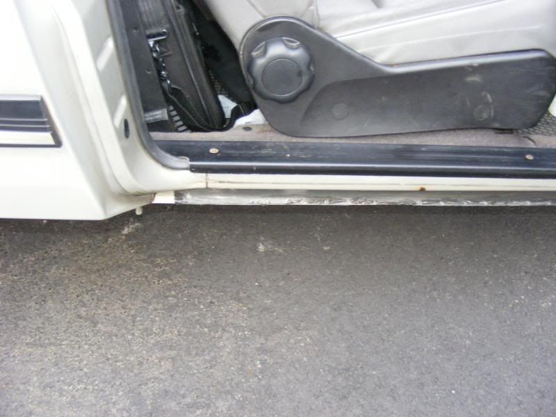

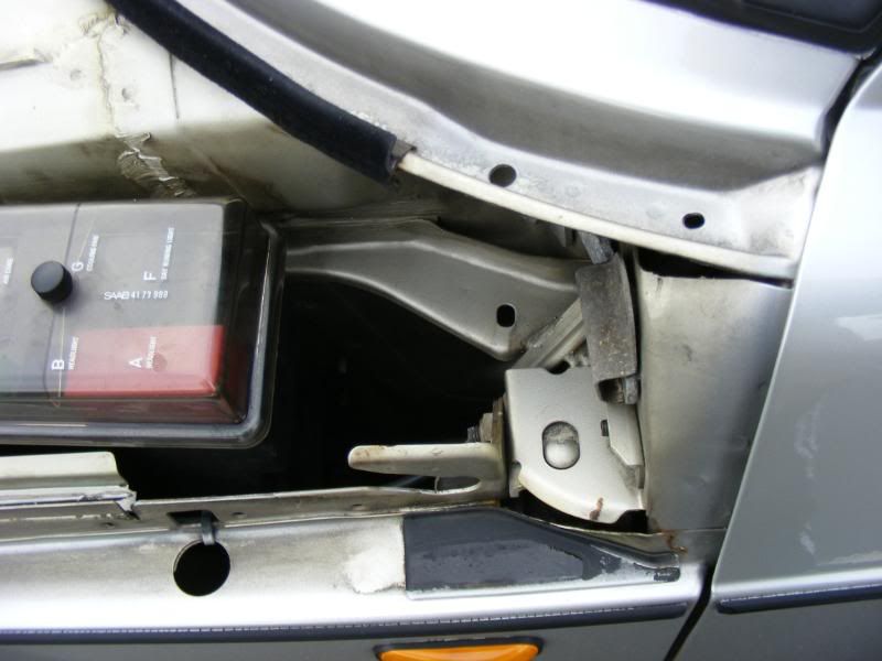

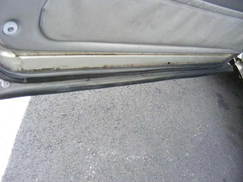

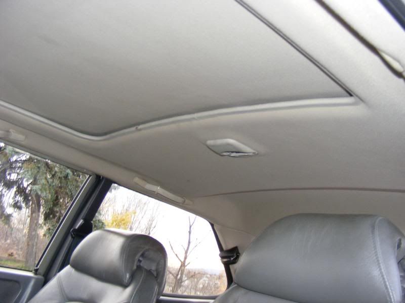

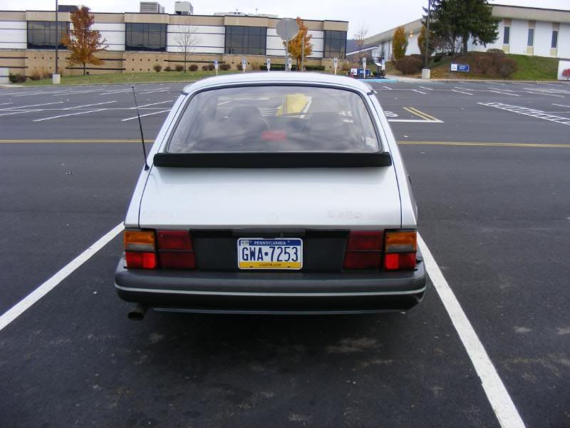

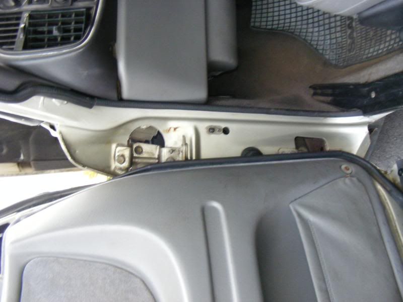

evidence of the ears early life rear-ending. There is no damage to the frame what so ever, however there is also some slight buckling under the trunk liner. Should be fixable.
