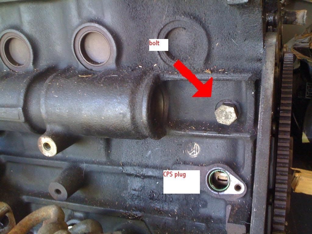

Has anyone hooked up the oil pressure sending unit to the front of the motor? Seems much easier and roomier to get to since there's no starter/intake/vac lines to feel around. Plus, you can actually see what you're doing! lol
Took this pic on my old motor that's in the garage. The bolt seems to be the same as the one that's right above the starter in the back... Let me know if that's possible and if it's even an oil channel. Thanks

I think thats a coolant port. On my 900 turbo, which should have the same block, one of the coolant lines for the turbo bolts on there.

On a 9000....nothing bolts to that spot. Coolant lines go from the water pump to the turbo, then from the turbo to the thermostat housing, or on the older 9000's, back around the throttle body to the back of the block area.
I believe the oil pressure sensor location on yoru 9000 is on the back of the block, and it has 1 electrical prong stuck on it. Its about right smack dab in the middle; top to bottom, and left to right. Look down under the starter area. Easiest to see from underneath.
Thats what I figured. He still wouldn't be able to use it for an oil pressure sender since its for coolant though.

I took the bolt out of the front of my old motor and it was sludgy instead of clean like I would think a coolant plug would be. I also took a white wire and put it into the hole, came out with black sludge as well. Matched up the bolts and they are the same too.
In regards to the rear oil passages, I took a pic as well from the stripped motor. My plan was initially to install it to where the bolt was and leave the stock sensor in place for backup. I'm a little gunshy do to the fact I have a old dead motor do to lack of oil pressure:rolleyes:
rear of motor: you can see the stock oil sensor on the right and hole where the bolt was on the left where alot of people hook them up.
Does anyone have a schematic on the passages? I'm just thinking it would be soo much easier up front. Wouldn't even have to jack up the car! lol

Just found a pic of a 900 with that as the coolant line banjo. That sucks. Don't see why they wouldn't just have the same set up for the 9k instead of going around the side of the motor... Worth a shot I guess.

Thats definitely a coolant port for the turbo. I think you've got the right idea by just moving the factory sender over and installing the gauge one in the middle on the back of the block.
