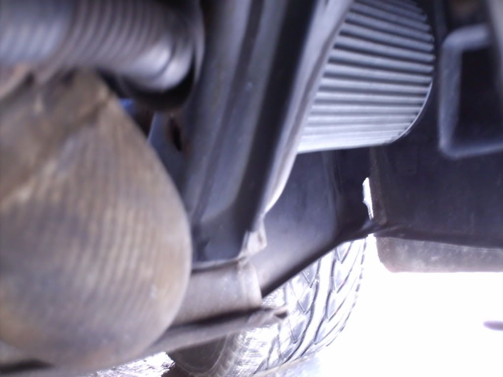

So i made another cai out of left over intercooler piping from the spg and heres what i came up with. Im very pleased with the performance sound, i dont know if i would say that its a real hp gain but it opened up and let the eginge breathe easier and cooler air. So here ya go
i wanted to take pics of teh cai out of the car but i got to anxious to put it in, but you get the idea.

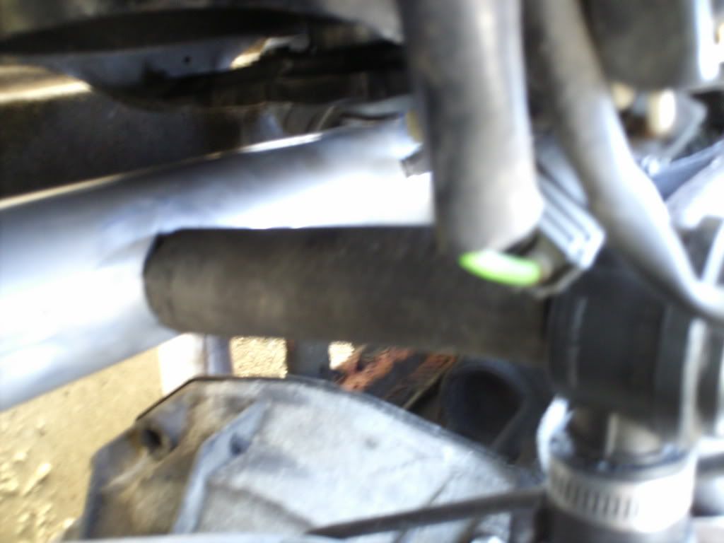

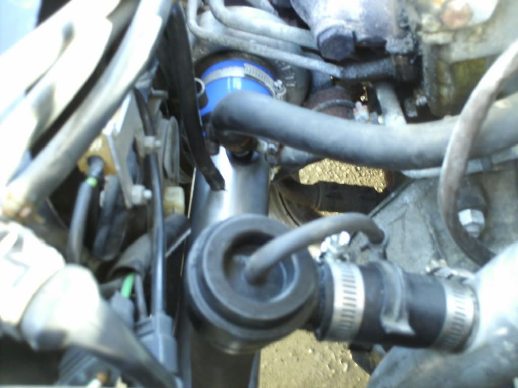

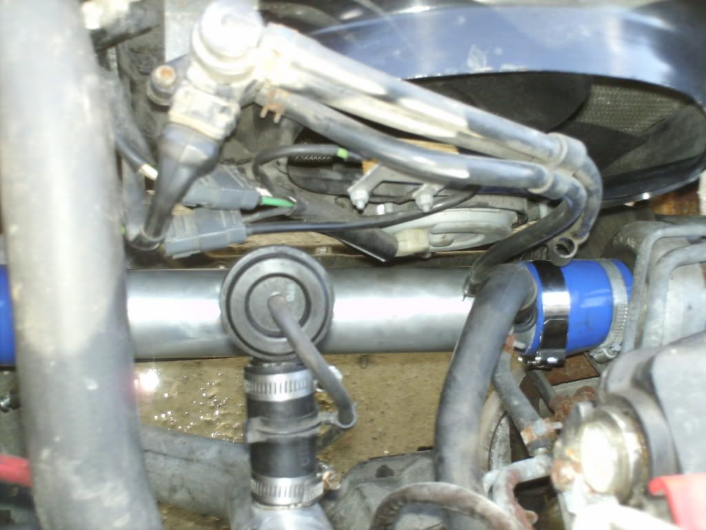

Either cap or weld the water line to the turbo and plug the bottom hose from the tb that goes back behind the head & engine block. The crank vent you can just run to an oil catch can.
12,348 Posts
Turbo water line:
TB water line behind head/block:
I actually cut part of the hose off so it wasn't as visible.
