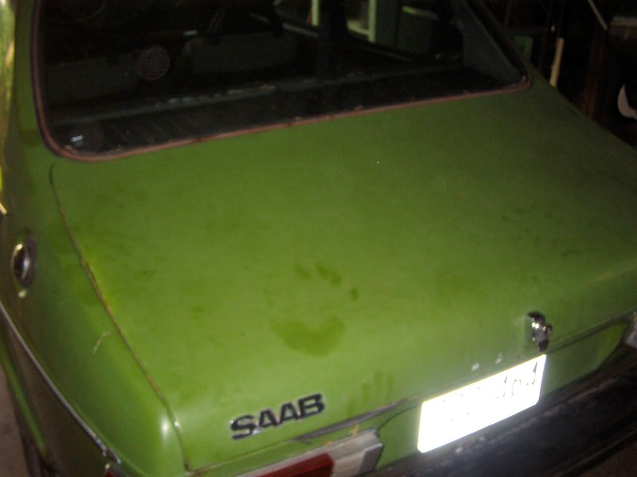

I looked at this '73 99 near my house yesterday, advertised on Craigslist:
http://minneapolis.craigslist.org/car/715094003.html
and I went back today and bought it.

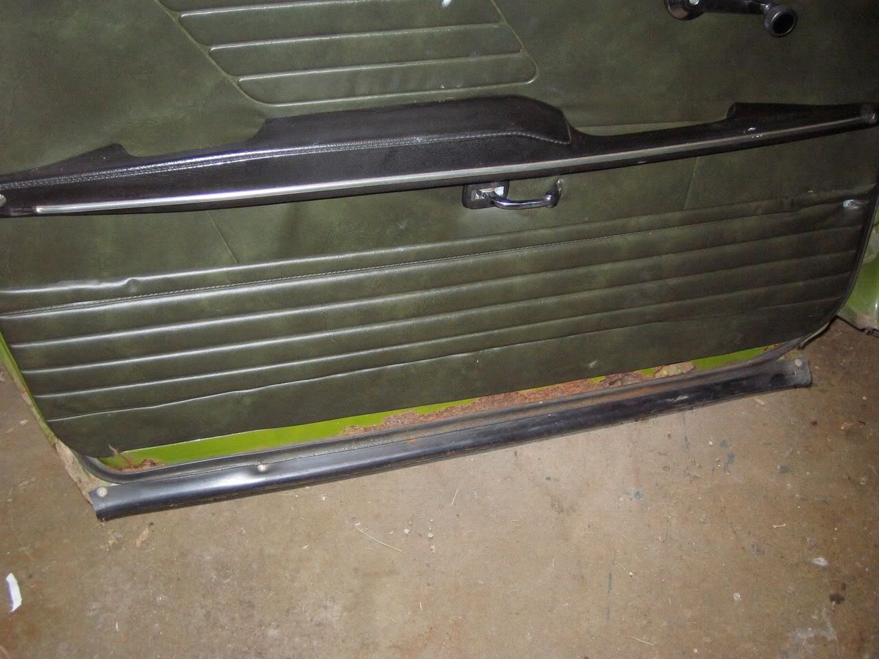

The good news is the car has 91,000 original miles, and is astonishingly rust free for a MN car. The only real rust problem on the whole car is the typical door bottom rust. The rest of the body is shockingly OK.

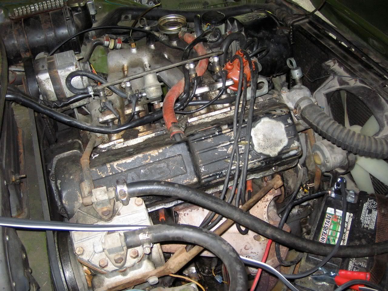

It starts and idles (after the vacuum hose to the distributor was hooked up, the old gas was drained and some new gas put in).
I was able to drive it up and down the seller's driveway. The brakes stick after the first application. Yesterday they were still sticking, but this morning I banged the brake master with a wrench and they loosened up enough for the 100 foot test drive. Whether that's the brake master or just 24 hours for the calipers to unstick, I do not know.
The turn signal dash light sucks power even when the turn signals are not activated. You have to pull the fuse for that circuit or the battery will run down. Apparently that's a fault in the turn signal relay, which I will need to replace.
On Monday, I'm going to have it towed to my office building parking lot. The basic agenda is getting it to run and drive enough to be mobile, change all the fluids, and then wax the living daylights out of it.
I'll have to redo the brake master and calipers to have any real confidence in driving the car, but I hope I can get it mobile before doing that -- to get it in and out of the garage for some weekend wrenching.
Here are the obligatory pics -- more and better pics after I take possession on Monday:

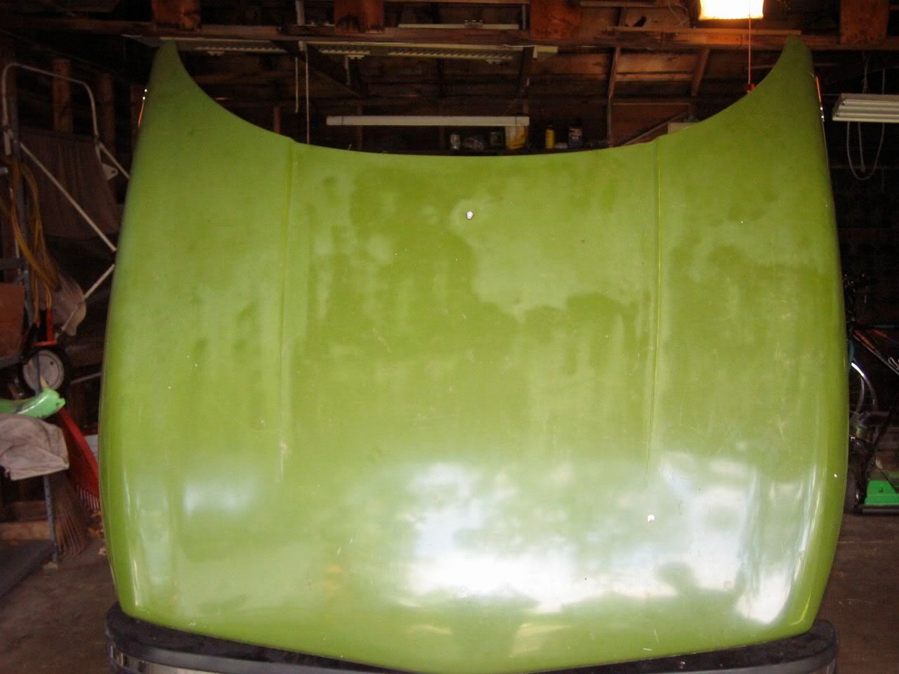

The paint is faded as shit, but it will come to life with very little work.

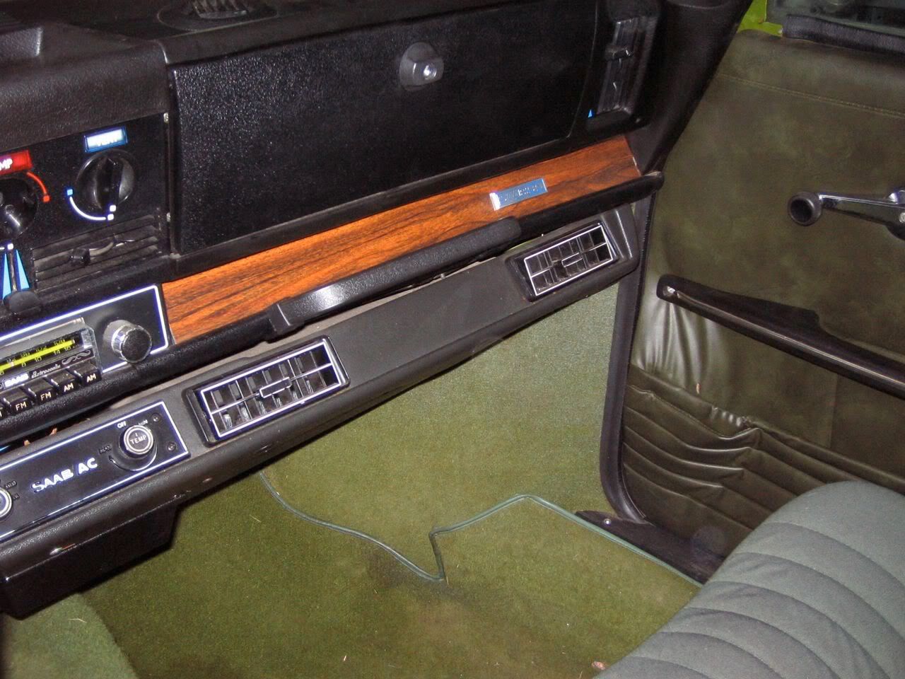

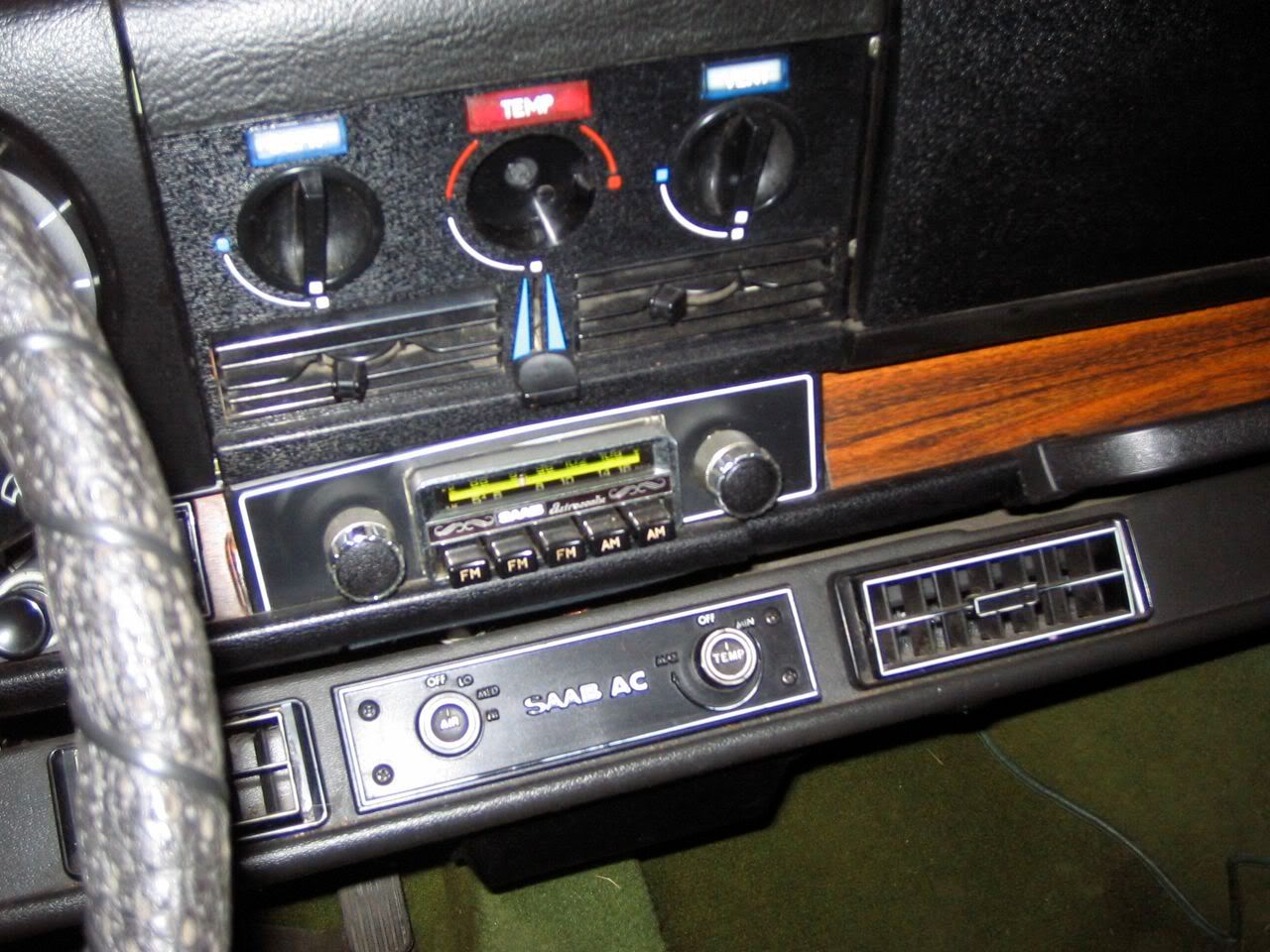

I love where it says "Saab AC" lol
Yeah, that's cute. I wonder if it's worth trying to get the AC to work again. Probably not.

fix the battery tray grounds now rather than when the D-jet stops working :lol: Looks like a nice find. Does it have power steering? Some of the 99-automatics had it, none of the manual trans cars got it.

Well, after the intensely high tech fuel filter replacement procedure, I was able to get the car to run. And drove it home, where it is now parked in front of the house.
It's still running rough. Plugs, wires, etc., still need to go on. It seems to make a noise under load, which may just be a big miss.

Well, it's amazing what a fuel filter, new battery, 3 out of 4 plugs and wires will do for a car.
The car seems to be running fairly well at the moment. Starts up very quick, idles and revs nicely. I had it up to 45 mph! Could have gone faster! It shifts and drives like any normal car with completely blown shocks and a power-sucking automatic transmission designed in the 1960's.
Is there a trick to getting to the spark plug on the #2 cylinder? My socket wrench can't move without an extension and I can't use an extension without running into the AC compressor. (Do they make a half-inch extension? That's about what I need to get some room to move the wrench).
I believe the old plugs were the wrong kind as well. NGK's but with the "R" for resistor. I presume this car does not use resistor plugs. The old plugs look terrible, too.
