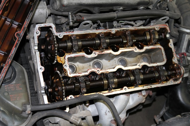

Towed in last week with no start. Fuel and spark great but no compression, Found the cause when I lifted the valve cover. 2 plugs clean, 2 fouled. Was planning to ckeck the cam timing. :shock: Not really a need.

It ate the chain and there was lots of shiny Alu down in there. ;) Weeping fresh oil from the cover cracks after it sat overnight. I have not seen one that lost the chain though. Maybe a few broken guides and noisy or a sprocket.
I have a ~60k motor in the warehouse. Not worth replacing though.
