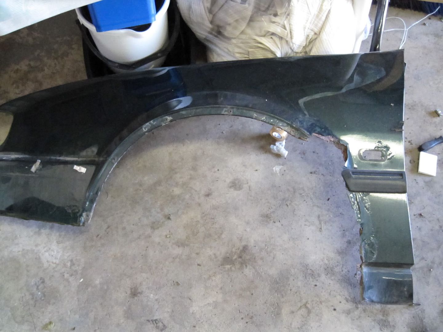

Shots from last weekend. If I'm lucky, I get one afternoon a week to work on my 'to do' list, which is long...may be another month before I officially get the car on the road. Apart from changing all 4 rotors and pads, attacked the body and interior:
old fender:
Here's the junkyard find which will be resprayed. Still needs to be aligned perfectly.

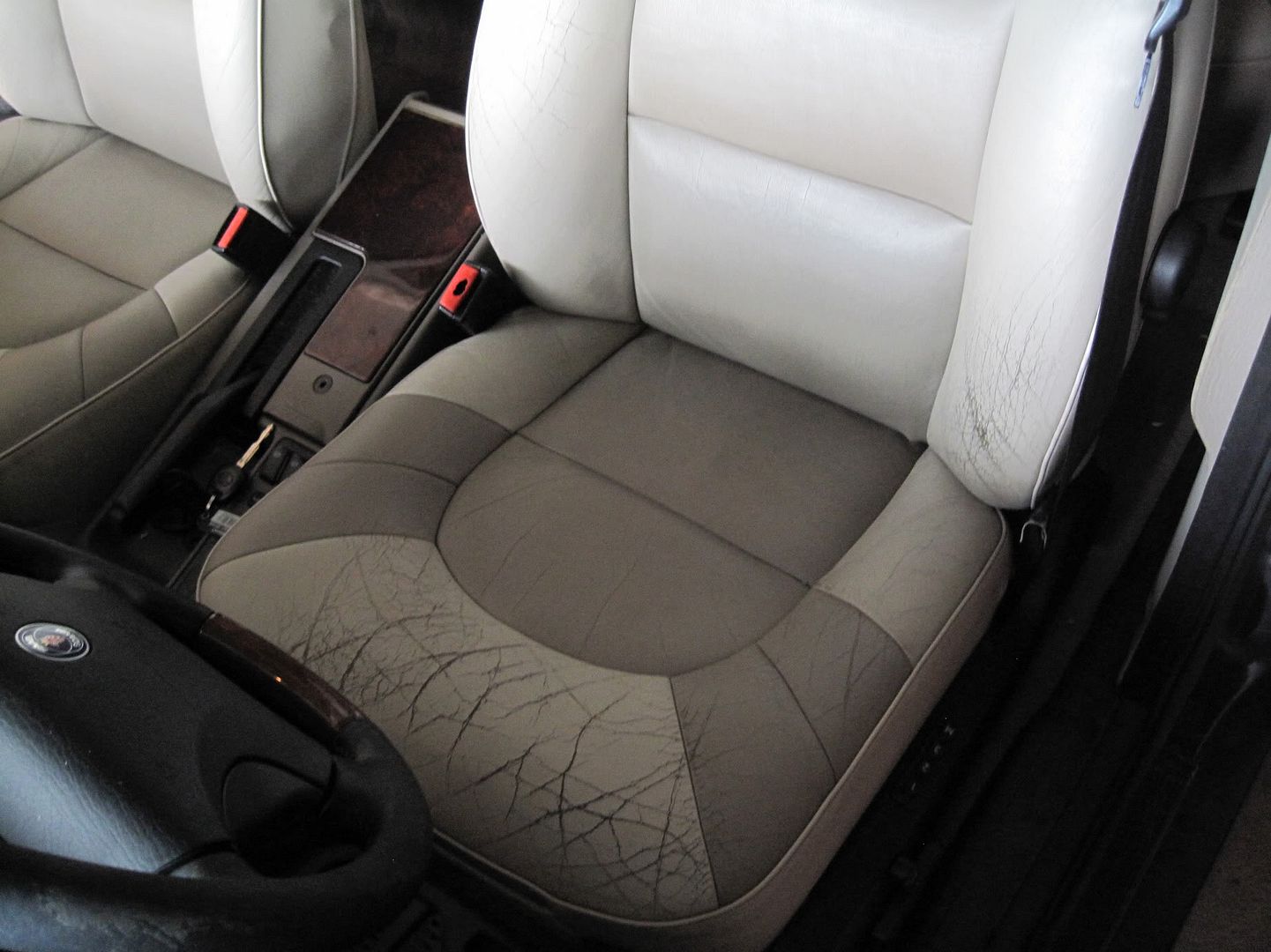

Full cleaning of the seats.
1. Wash with soapy water and dry
2. Scrub lightly with Mr. Clean Magic Eraser
3. Lather on Leatherique conditioner
4. Clean with Leatherique cleaner
5. Dry again
6. Condition once more with Simoniz leather conditioner/cleaner
Apart from the cracks, the seats look like new. The lighter shade of the two tone seats went from a tan cream to a white cream color. Will probably fix the cracks and re-dye the seat bottoms as well.

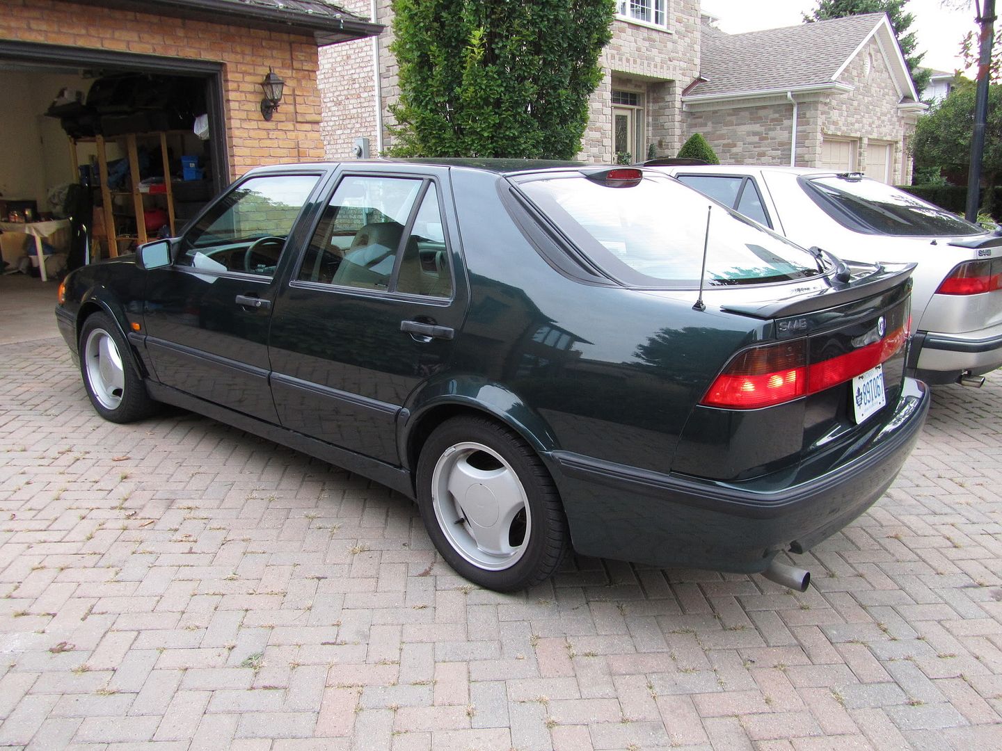

Finally had some time today to mount the bumper.
I ended up doing away with the original clips on the fender and cut them off. Removing them revealed the fender holes which made the solution simpler. Had some leftover clips w screws from a junkyard wheel arch moulding and simply hooked them into the bumper sides and secured them on the other end of the fender with nuts. Looks perfect and flush now :)
Latest shots from today:
This is the best I could align the fender. Slightly narrow towards the edge of the hood but otherwise its all good:
Had the hood resprayed also:
