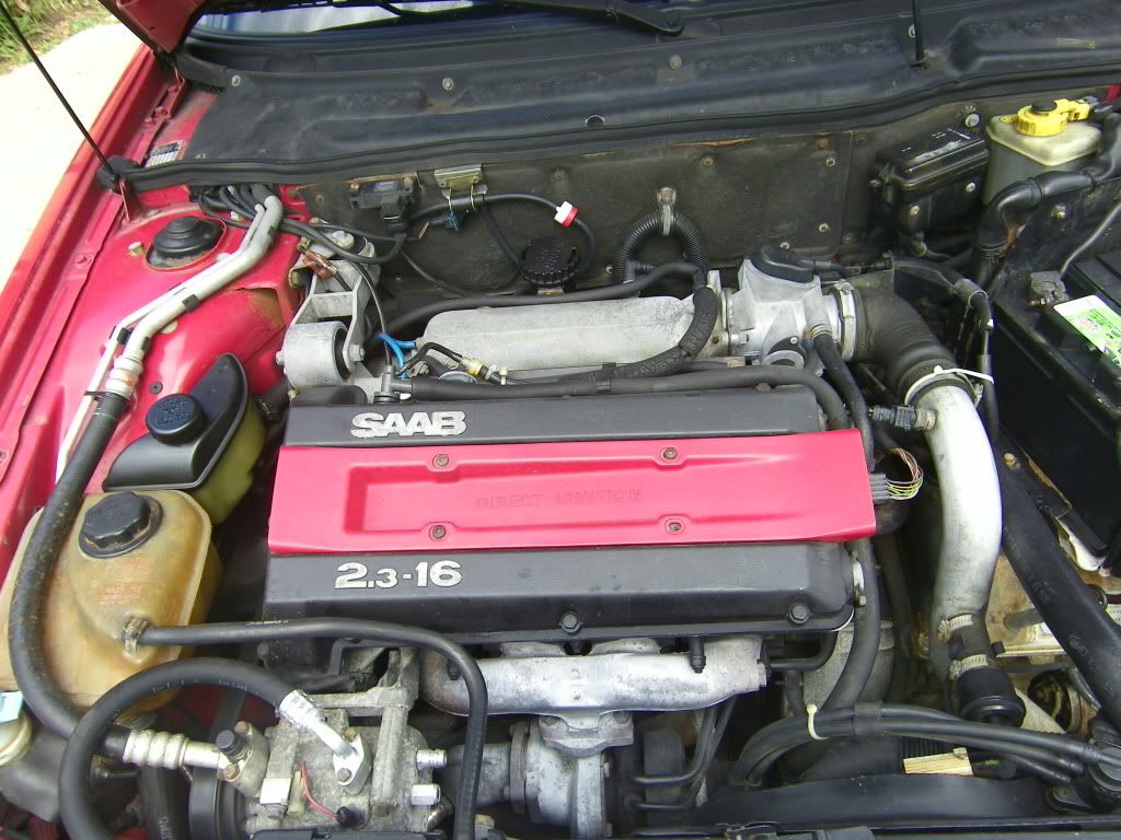

Oh wow thanks for the part numbers but now .. Ive always wondered which motor I have.. Lol how do I know (Oh gawd what a newb question IM SO NEW TO SAABS :p)
