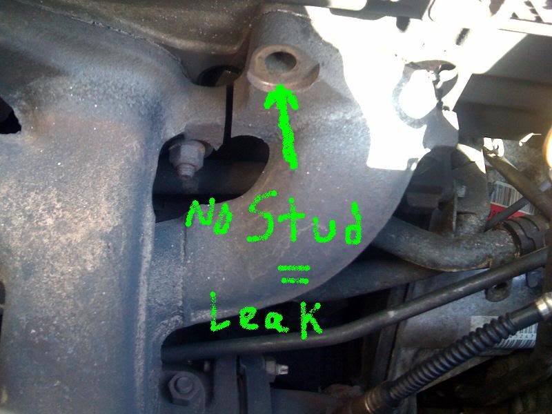

So I was in the middle of changing my Vac Lines today and Decided to rev the car a bit. I noticed that smoke was coming from somewhere under the turbo heat shield. I decided to take the heat shield off and noticed that the smoke was coming from where the stud is missing on the manifold. I posted a pic so you guys could see.

yup. theres your problem. is it broken or is it missing?

I am not sure. Is it an easy fix though. Is this something that would negative affect the engine if it wasn't taken care of immediately?

Ok so I will have to get a new gasket and stud from the dealership and hope that the stud did not break inside. Hey you guys know of anyone who makes custom manifold for the 9-5
3,998 Posts
missing is an easy fix. broken is not an easy fix and I would recommend having a machine shop fix it, having personally fucked up a stud removal or two.....
and as palmer said, you'll be down on power.
people *have* made them. but they're custom.....
I am keeping my fingers crossed :) Thanks for the help guys.
1,956 Posts
No, not really, but it will make you down on power...
I've not experienced it myself, but have heard it said and it makes sense. With an exhaust leak that close to the head I have heard that cold air can get back in after you shut the car off and cause the valves to be damaged because they cool so rapidly when the rest of the car is so hot.
It makes sense, but anyhow something you probably want to get taken care of soon.

What the fuck... this just happened to me, as well. Except it was the far left one under the manifold, and I didn't notice it until I got an exhaust leak that sounded like a dying animal of some sort. In my case, it just managed to completely back itself out and get stuck in the engine bay. I checked the others, and 2 were ridiculously loose.
Weird shit.
Weird shit.
Sorry to hear that. The way I see it..it could be from all of the engine vibration because boy does that damn engine pulse a lot..But at least your stud did not break. I still haven't checked mines but it could be that mines got loose as well. It wouldn't be the first time that I've had to re tighten a loose bolt/screw.

My sound was obviously an exhaust leak, just a very strange one. Almost like a high pitched bird squawk, or as my lady friend said "it sounds like a dying squirrel".
