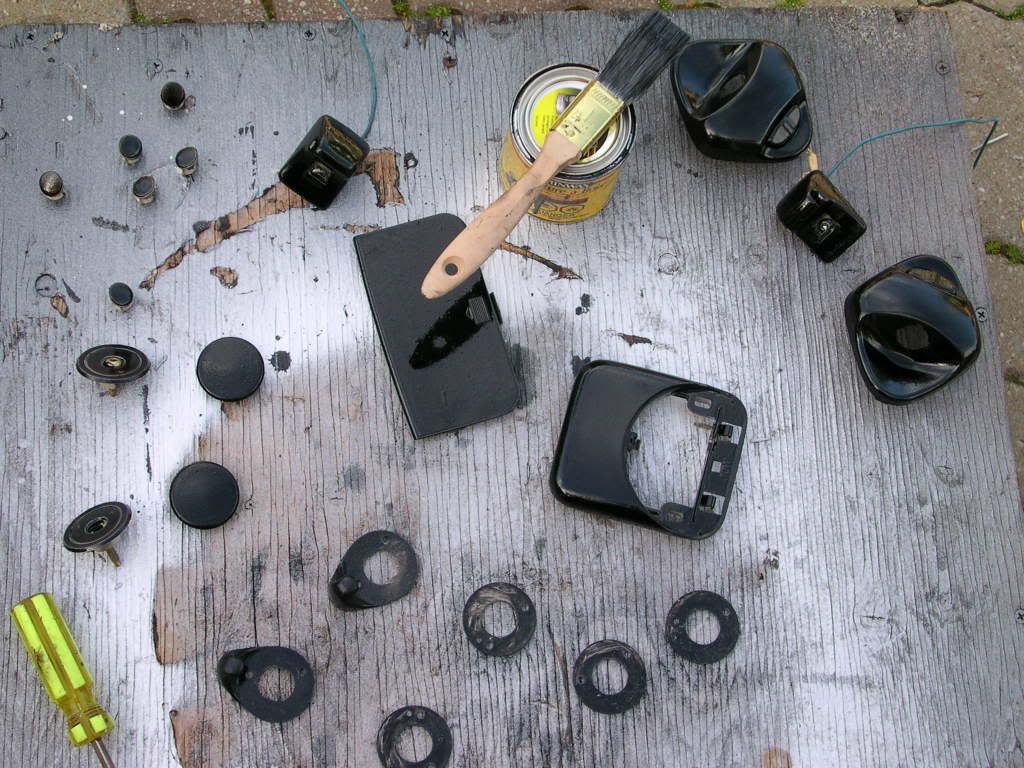

Headliner installed, still have to paint a little area on the sunroof sliding shutter and put a handle on the driver's side front. But other than those two things, job's complete. I gave up on staining and opted to spray paint the trimmings with Duplicolor Vinyl Black Paint. The paint is very good, it adheres great, dries extremely fast and gives a very nice finish, it also looks like it can handle people grabbing onto the handles without scraping off. Some pictures (wasn't the nicest day and taking pictures of black upside down doesn't give the best results)
Used for trimmings:
With Flash:
