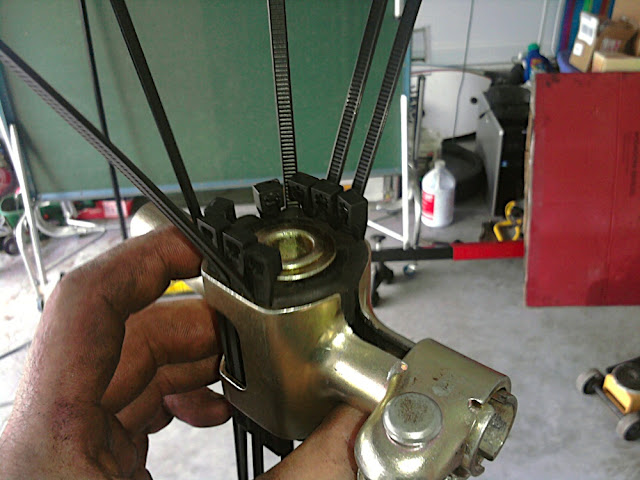

Gearshift linkage is all fucked up. New parts in there, but it's hard finding gears. Last night I couldn't get it into reverse for a while, and this morning 1st/2nd were impossible to find after driving for 5 minutes. It's no fun going through the Dunkin Donuts drive-thru in 3rd gear.
Now it's just fiddling with the crappy ScanTech shift linkage. My old linkage is tighter than this new one. wtf? It's causing me to have to shift into Reverse before I can find 1st; 2nd is missing... goes into 4th.
I'm gonna pull it off and see if I can shim both sides of the linkage to tighten it up. Maybe put the old one on....

I pulled off the new ScanTech shift linkage, and it was loose as shit. No wonder I couldn't find any gears. So using my sober McGruber skills I made this:
It works great! I'm impressed with how much tighter the shifter feels (relatively speaking... it is a Saab)
when you say the shifter feels tighter are you referring to your old linkage or the new unmodified scanwest one??
IIRC, it was noticeably better than the original, 150,xxx mile old, linkage. Metric shit-tons better than the new Scanwest unit. The rubber in the Scanwest was extremely loose. I'd love to cram some poly bushings in there if they made 'em.
Thanks, I've gotta replace the trans in my car and the 256k linkage too. I'm gonna buy the scantest one to save cash and do this to it. I'm also toying with the idea of stuffing some window weld urethane to help stiffen it more.

I'm guessing you already know this, but the trick that works sometimes is to loosen the nut on the linkage taper-pin until it just barely clears the threads, and then whack it with a hammer.
I was successful doing that once before, but not the last time.
