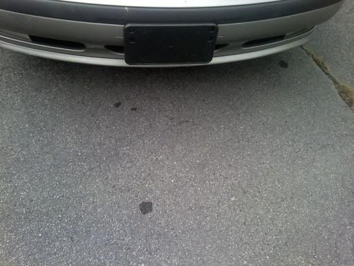

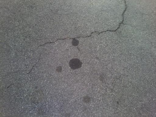

will you tell me me what you think of the leak if i post a picture tomarrow?
3,022 Posts
It's really difficult to tell that by a photo - you will have to use some common sense on this one. See exactly what's leaking. If it's oil, make sure it's not getting on anything rubber, the oil will eat the rubber, like hoses or the serpentine belt. You don't want it dripping from the cyl. head down into the clutch case for example.
Oil leak at the front main seal and oil pump cover is very common, the new seals are pretty cheap, and if left un-checked can make a big mess of the serp. belt.
If it's just the pressure switch, it'll just drip onto the car and smell like burning oil, but won't exactly hurt anything. If you have the money and motivation go ahead and fix them, but it's kind of a matter of oppinion. Some people don't mind topping fluids off once a week, some people know they won't do it so it's better to fix the leak rather than risk running low on oil.
Some people also have nice driveways or picky apartment parking complexes that won't tolerate leaky cars.
Drew
94 Posts
Discussion Starter · #14 ·
Drew
i don't mind topping it off once a week, but i wanna fix it since i got to school for automotive, and my mom is always yelling at me saying i hate my polka dotted driveway.
3,022 Posts
Ehhh, that's probably getting borderline. Find where it's coming from.
And always do whatever you need to do to appease you mom. My really leaky cars get a drip pan, or they just get parked on the street and squirt some Simple Green on it periodically.
If it's the oil pressure sender you should probably do it, since the leak is under pressure when the engine is running. Same goes for the oil pump.
To do the oil pressure sender pull the starter first, then the job is super easy.
If it's a crank seal, the #4 cyl. end of the head gasket, the cam cover or the distributor plug in the end of the head they're common spots for leakage on your series engine, and it's because the seal designs are leftovers from engineering that was done 20 years ago.
If you want the practice since you're taking tech courses definitely go for it, you've really got nothing to lose. The SAABs aren't particularly hard to work on, but there are lots of aluminum sealing surfaces, so make sure everything is clean when you go to put it back together, and don't use hard curing silicone sealant - it just makes a mess. I use Loctite 518 flange sealant for a lot of things all over the engines, cam covers too, it dissolves (or partially dissolves) in the engine oil so it won't get sucked into anything if it gets squirted onto the inside seam of any of the flanges.
If you don't have one already get yourself a single-edge razor blade scraper handle, it'll make your life really easy.
The other nice way to prep flange surfaces is with a 3M roloc plastic bristle brush on a die grinder, the plastic won't hurt the aluminum mating surfaces, and you get a nice rough brushed surface for the sealant to adhere to.
Drew
