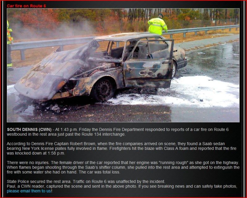

Lol, I didn't realize there were a lot of c900 fires? I know older VW are a lot more prone to car fires specifically electrical fires.

sounds like she fouled plugs and heated the cat till it got hot enough burst something into flames. i have a picture floating around somewhere of my Cat glowing bright red, more purple in the picture though
Even the new ones sometimes go up. The 1998 New Beetles had that issue when they first came out. Bad, bad wiring.

That may have been a CIS mechanical injection fueled fire, all the Euro cars from the '70's and '80's have stories of those lines coming loose or breaking and misting pressurized fuel into the engine bay.
The underside of the hood of my 99 is charred from a CIS fire, I can see where wiring was replaced, and had near new lines installed already.

The old 308 (Magnum PI)), Ferrari had a lot of fires as did the 60's Beetles. Problem with the Volks was that for some dumb reason there was never a clamp on the fuel filter. I think the hose clamp was a factory option for VW. :D

not "typical" to see this, however it could potentially happen with just about any 20+ year old car that has not had any work done on the fuel system ever. The return fuel line as well as the feed line could relatively easily scuff through or crack and if conditions were just right (or wrong rather), it would be able to catch fire. Like was already mentioned, CIS cars are probably about 10X as likely to have this happen because they have about 10X more fuel lines running around all over the engine bay :lol:
Also, electrical issues caused by 30 year old improperly wired car-phones, amps, stereos, fuse panel "additions" and people who thought they knew how electricity worked are always problematic at best with old cars.
