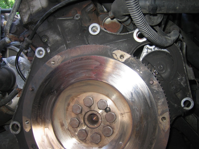

How bad is this flywheel? (pics)

I just unbolted it. Time to call up the shop.
Big Daddy Don Garlits lost half his foot to an exploding clutch. In fact, it severed the entire tube frame in half...
Yeah, I would agree. Do NOT resurface a flywheel with cracks in it...

g96nt:
I would NOT re-surface a flywheel with Cracks in it.
That's a good Way to loose a foot.

I dropped the flywheel off at the shop. Will know tomorrow.
There were small hairline cracks, and raised areas. The guy at the shop didn't seem too concerned about it, and I assume that he'd seen enough of these to know if there was an issue or not.

Turned out nice looking. I asked about the cracks, and the guy at the machine shop said they were a non-issue. The raised areas (galling? ) were what he really had to work on.
