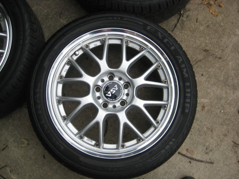

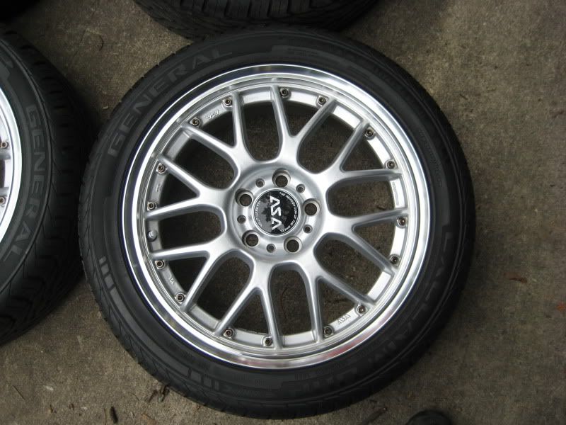

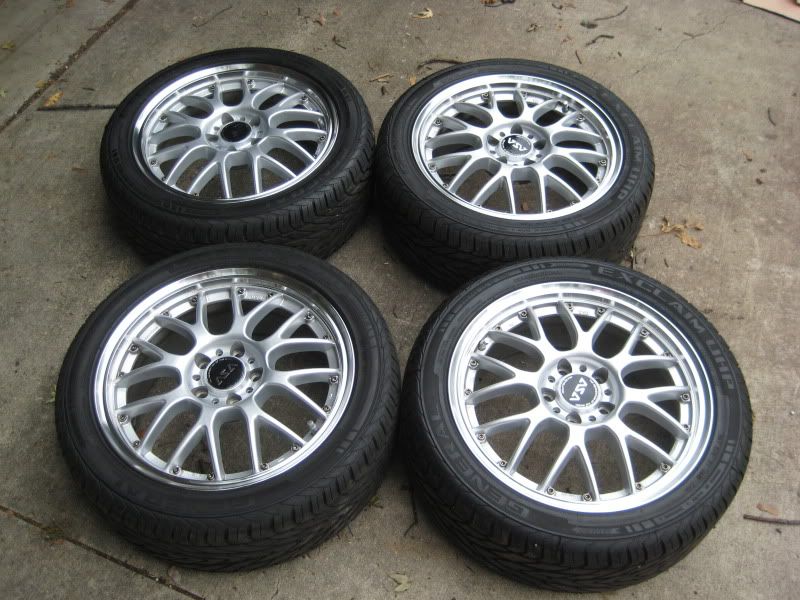

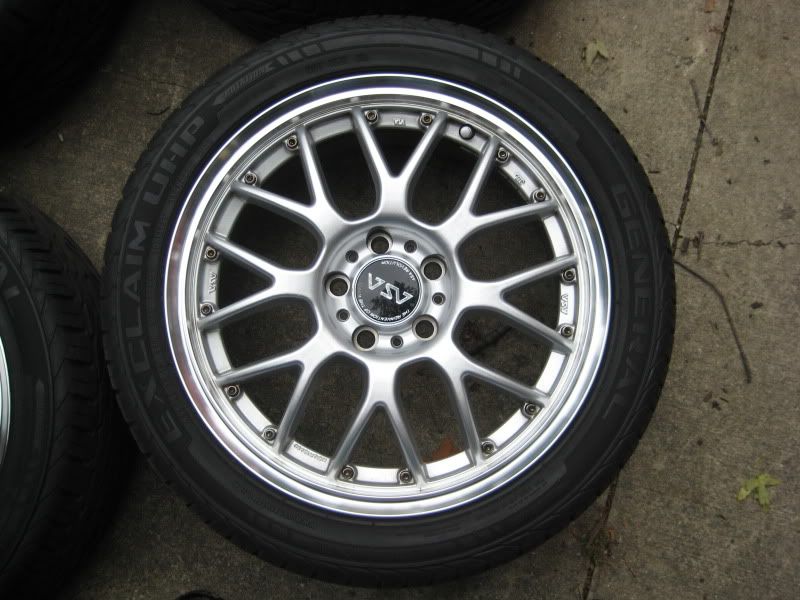

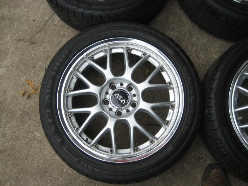

Asa AR1 Wheels with General UHP
Wheel Combo
ASA AR1 17x7 Silver w/ General Exclaim UHP 225/45Z/R17 Asking $500.00
Around 4,000 miles on the combo. look brand new. No defects what so ever. No scratches or curb rash. Bought in April from Tire rack for over $900.
Shipping would be from 60137. Local pickup in the Chicago area. PM me if interested.
