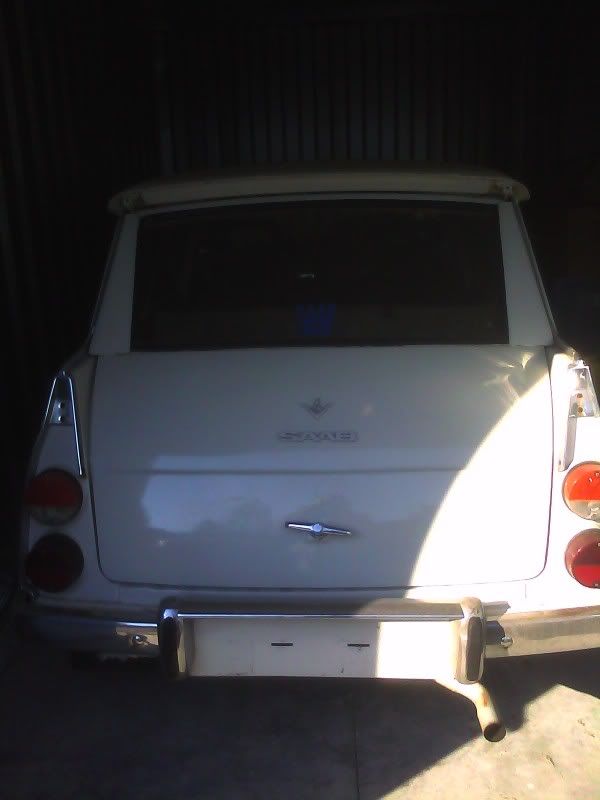

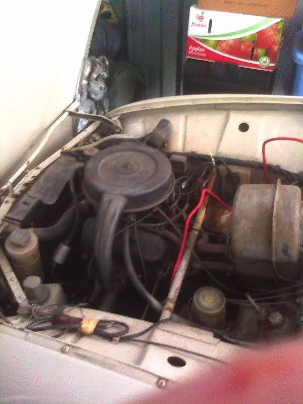

Anyone else know what a transmission "neuter" gear is??? Apparently it still works, sounds like something i wouldn't want to have....

Probably talking about the freewheel. Looks like a decent car, but always hard to tell from craigslist pics, could be a good deal, could be too much money, hard to say.

If I didn't already have one in the garage awaiting work - I'd be going to look at it to buy. Looks much nicer than mine did when i picked mine up (for not much less than his asking price) $2000 for a rather rust free runing and driving 95 sounds like a good deal to me - if it is actually that.
