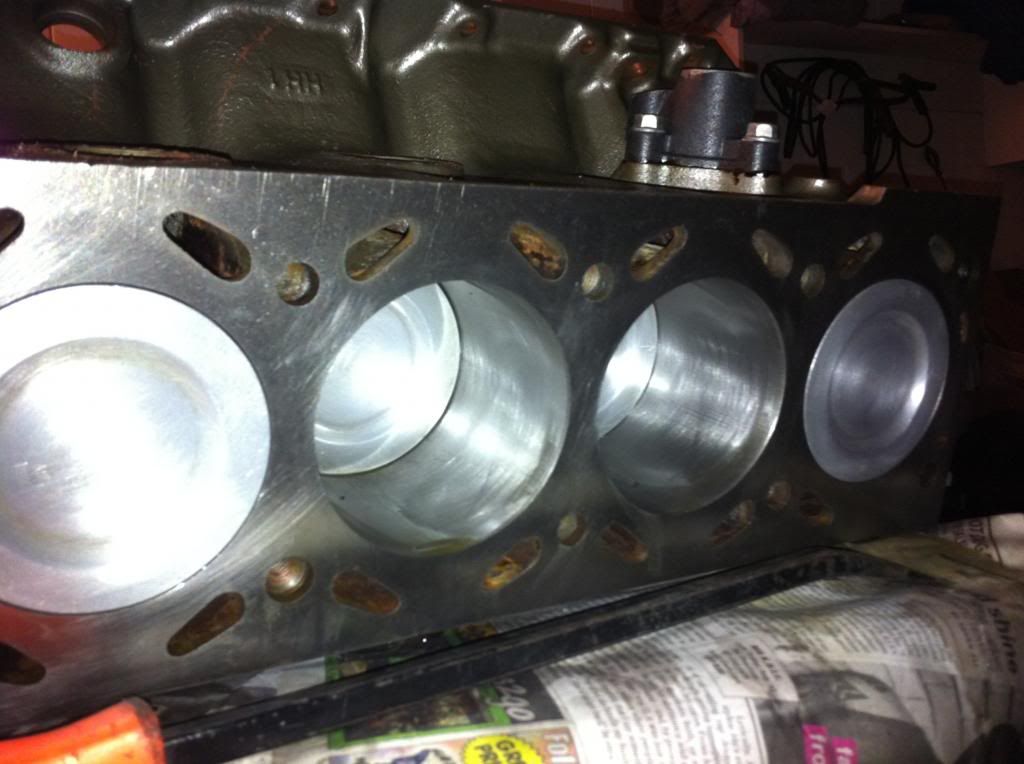

Well, she never made it home with the car, I had to go get them both. it appears the overheated cylinders cause some form of a detonation and BOOM, piston 3 had a curled crown.
I been running this thread in another forum but since posting here I appreciate the temperament and would like to share my experiences here as well.

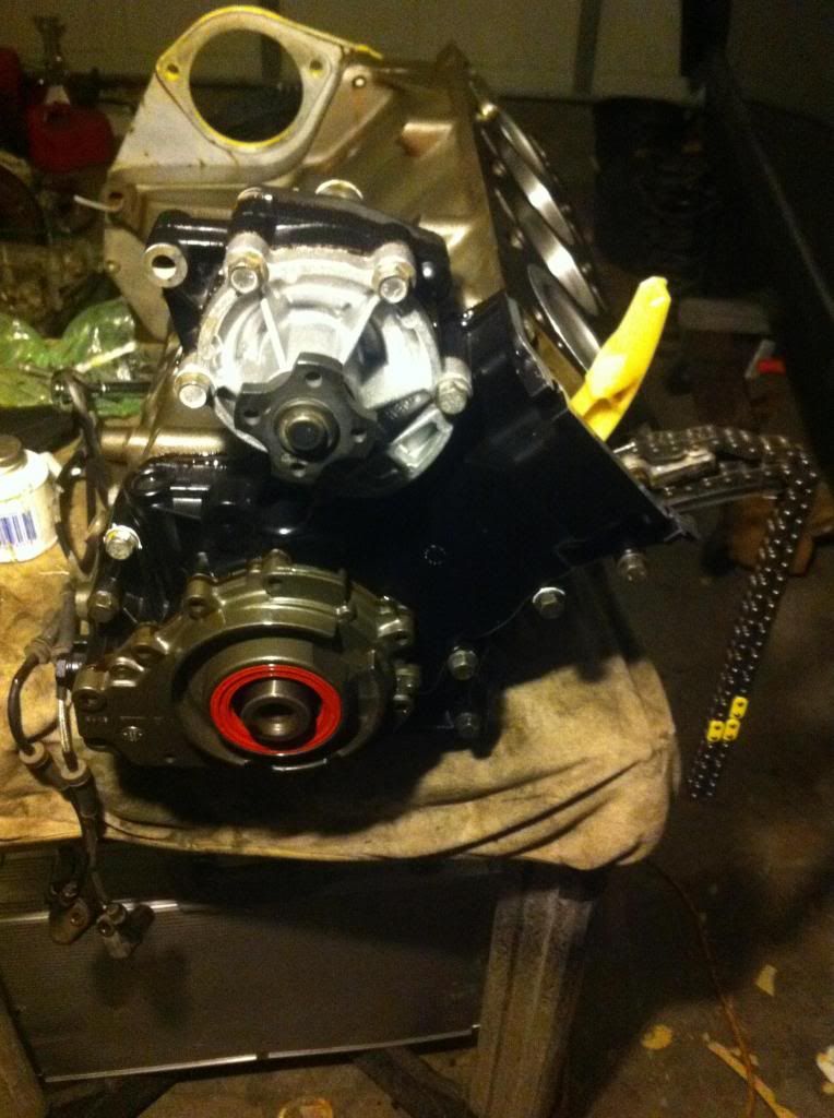

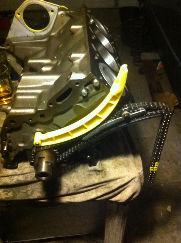

I have already rebuilt the motor and tranny is in good nick.
I will pick the project up here as I begin to refit the motor and get all the aesthetics in order.
Basically I already cleaned all the grease and did all the boring stuff, now I will document the build here and get her back on the road.

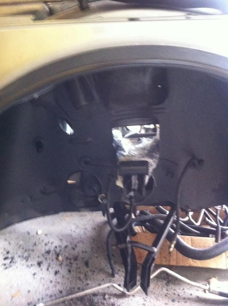

Here is the car before I pulled the motor

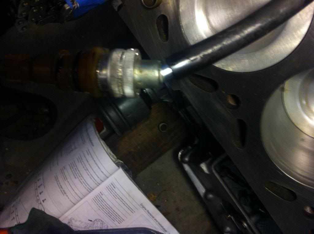

On a side note, I had the intention to replace the oring, ball bearing, and oil seals in the inner drivers.
I had already did this job on MY92 NA and the driver cup came out without much issue after I removed the bolts.
When i removed the bolts on the 91 Vert at the inner driver cup, the cup would not budge form the differential. after a few quick tugs, I stepped back, did a beard stroke and decided, "To leave Well enough alone!", honestly I cannot say either was leaking prior to engine pull so I wont fuss with removing them. I will just change the speedo O ring and be done...
Actually, thats where the oil seesm to be comong from so i pray I replace that small part all will be well and dry...

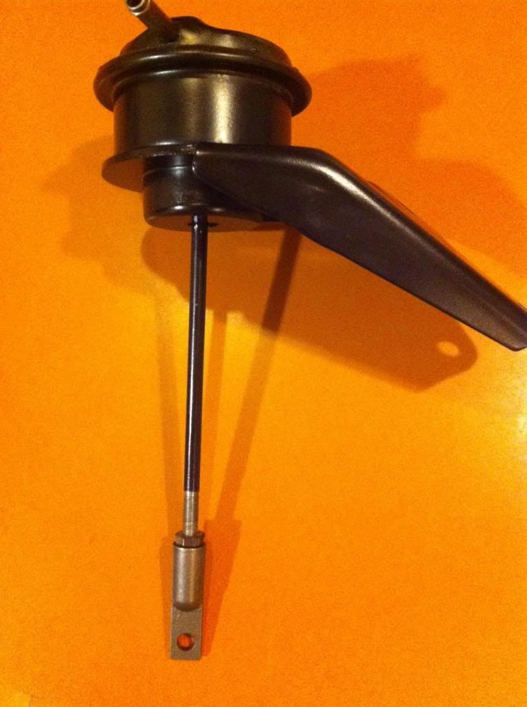

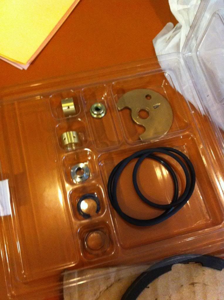

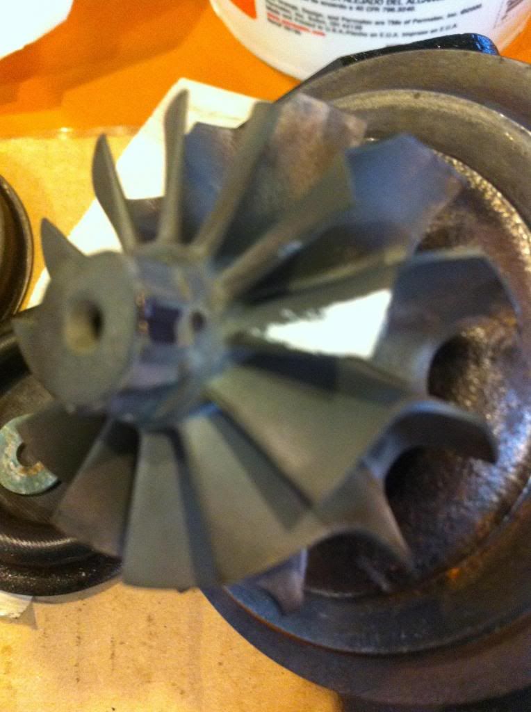

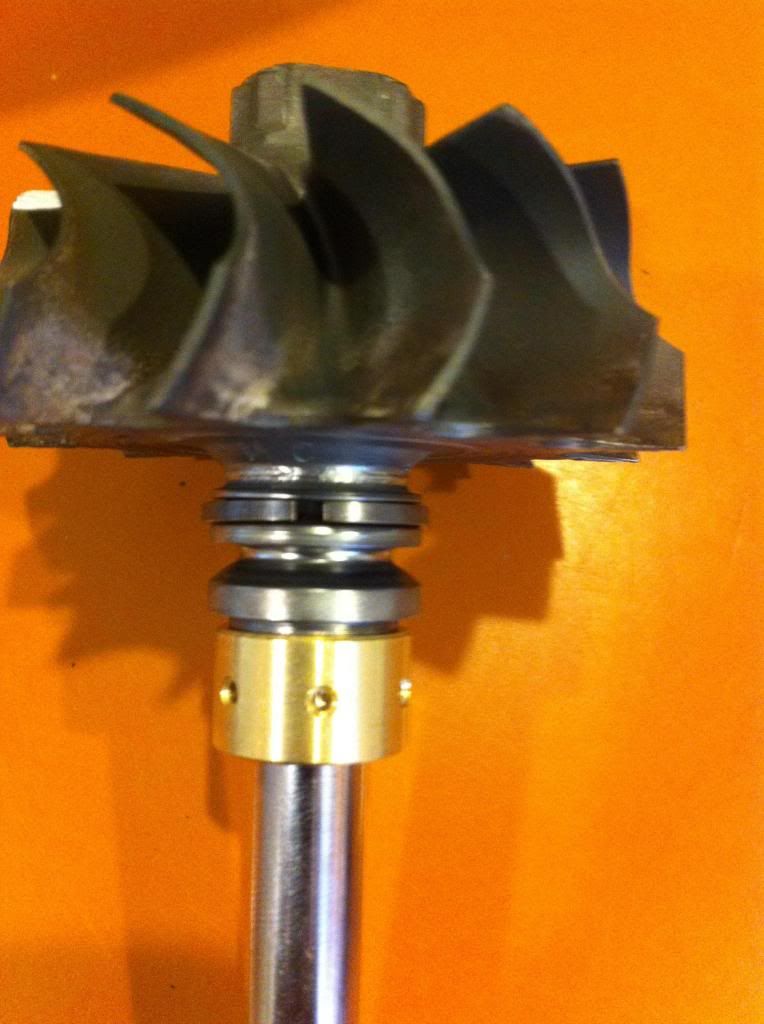

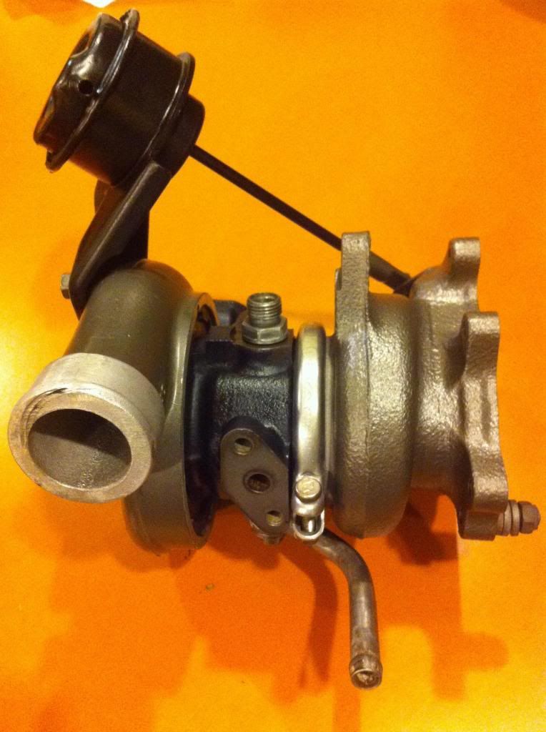

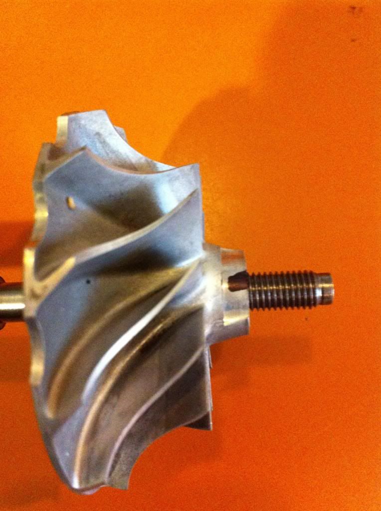

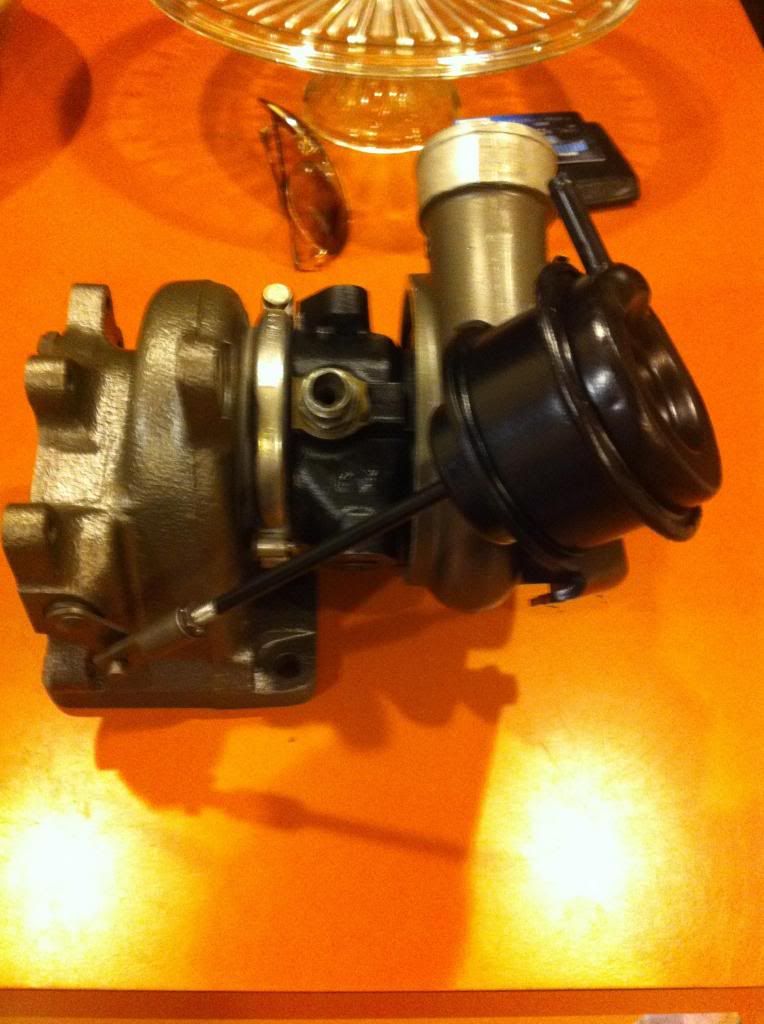

Rebuilt TE05
Proffessional balance:
Polished shaft with new bearing:
Waste gate was opened, spring greased, closed & painted:
Thanks, my first SAAB was a 1986 9000 Turbo, I purchased back in 1991 (loved it in every essence of the word LOVE). I reunited with these cars in 2009.

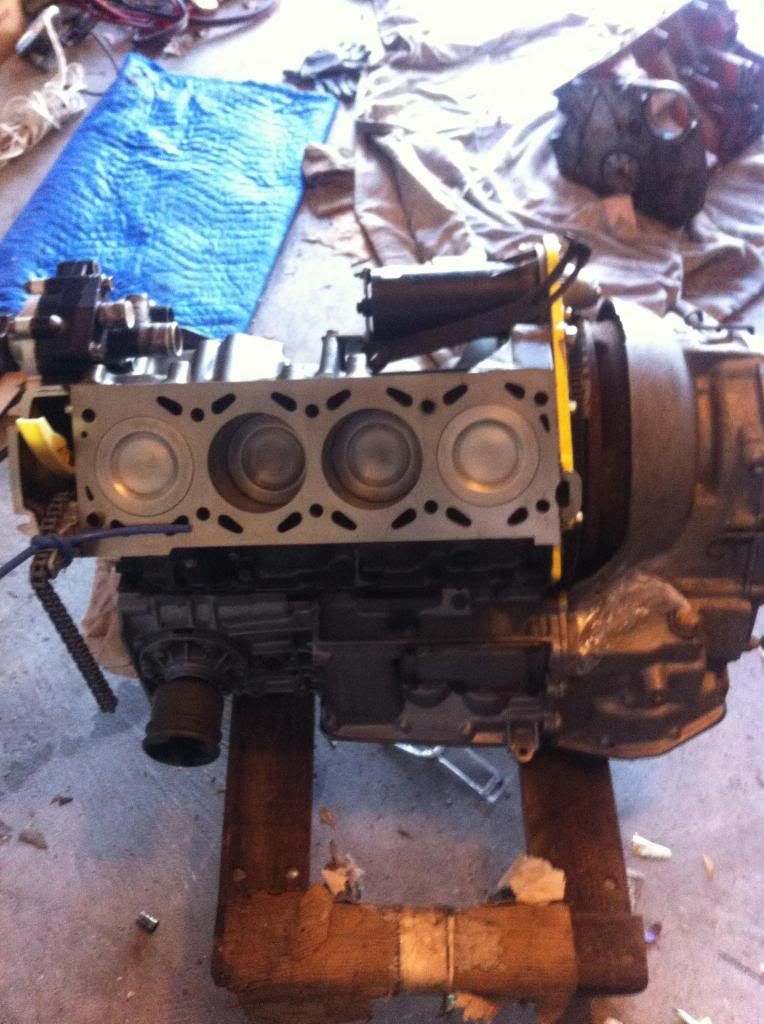

This jumps me waaaaay ahead of plans. With a gasket I can actually put the motor back in the engine bay

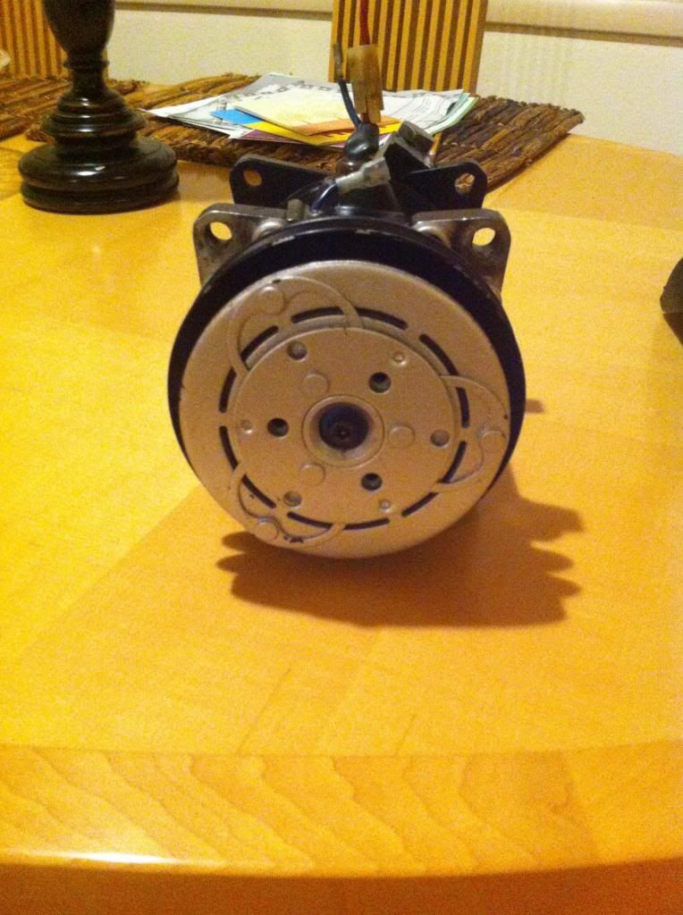

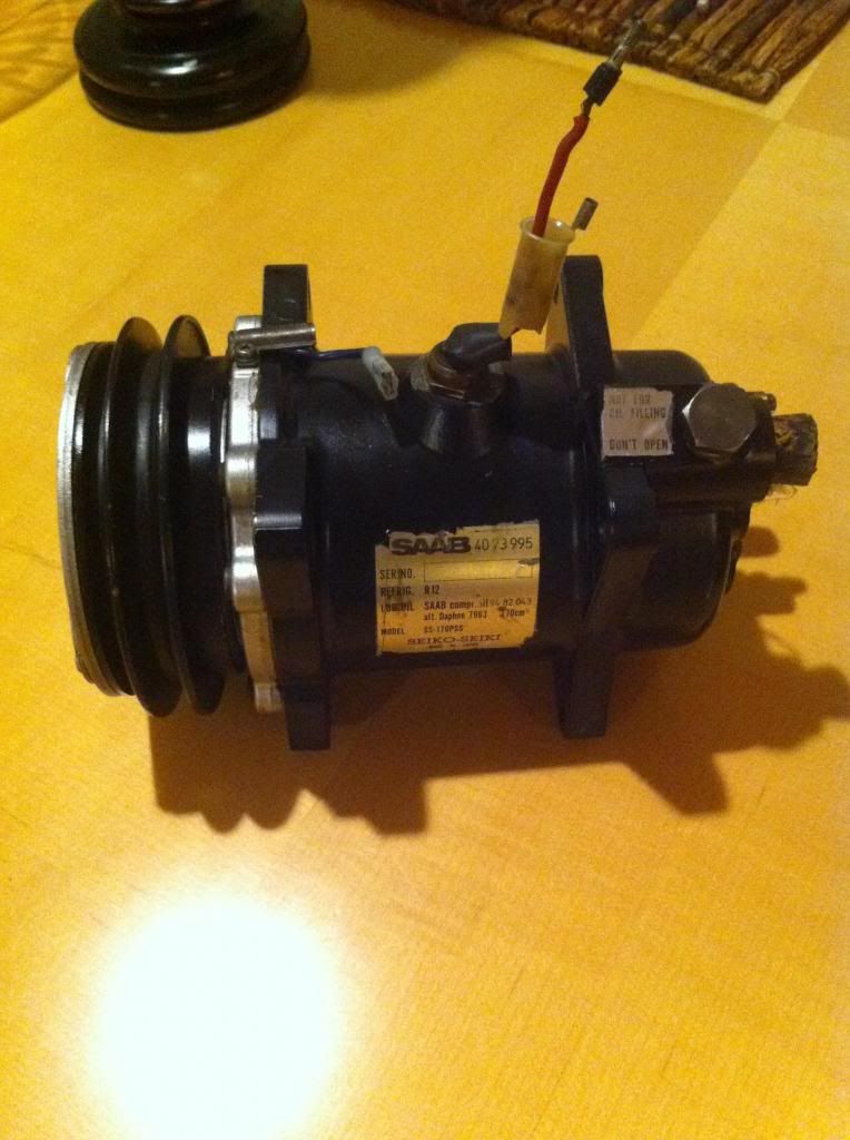

Plans ae to bolt in my 2.1 head, intake mani, PS pump, AC compressor, and get my ex. mani to the welder...
I tried to pull the driver cups last night and after removing the botls, it wouldnt budge fomr the differential. I just cleaned the old thread sealant and put new sealant and repalced the bolts.
After lookinig really good, it seems the only thing that was leaking is the speedo cable. I will put a new Oring there and hope for the best...

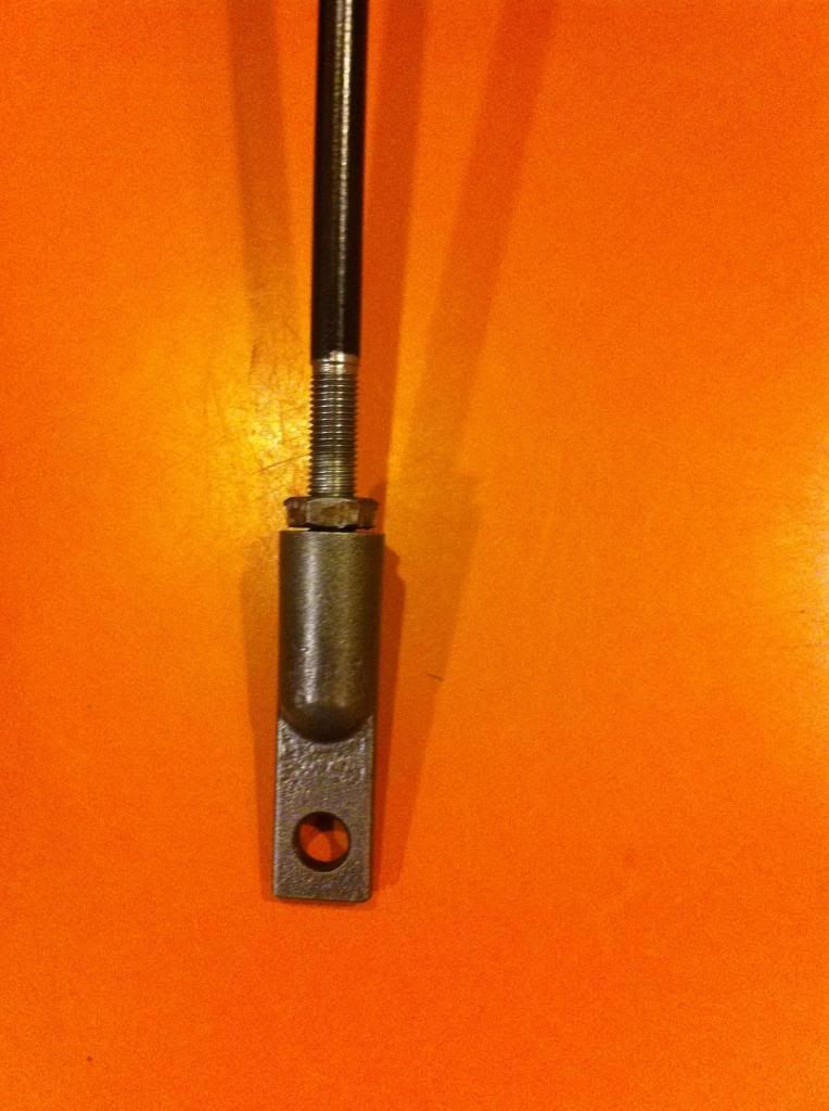

Speedo Cable
Question:
Should my speedo cable be slightly bent like this?
It's about a 45 degree angle..
Thanks...

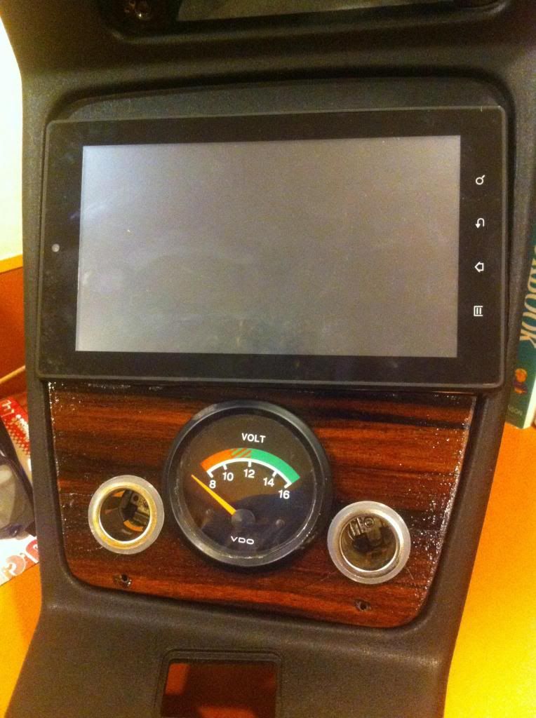

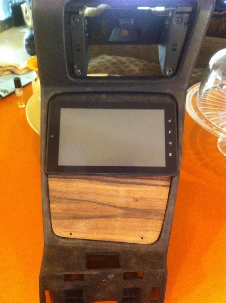

I had an idea to fit a small tablet in the lower console. Underneath the tablet I want an outside temp gauge and auxiliary outlets for cell phone chargers.
The tablet is a 7 inch screen, fits perfectly in the lower din. After careful trimming, and cutting veneer for the auxiliary and temp gauge here is what I get so far.
The screen sits flush, veneer has been drilled for decorative mount bolts. Just need to cut the holes for the gauge and outlets. The Veneer will be stained and finished. Thinking about cutting a trim piece of Veneer for above the tablet.
I will use commercial grade Velcro to mount the screen.
#17 · (Edited)
I decided to finish up the console work this weekend. Still not done. Just a but more sanding and final finish coat of the veneers but here is a shot of the semi finished product.
I also added a piece of grey micro suede at the rear of the ash tray frame to deflect the stock light towards where the phone will lay (well, that's the plan anyway).
I probably need to add a trim piece of veneer above the tablet and my fingers are itching to recess the tablet about 1/8 inch but then I gotta fuss with supporting it. As it rests it pops up just a bit.
Give me your opinion on how it looks.

Fired up the tablet tonight to see what it looks like. This is summing up to be a very practical mod. Should definitely bring more attention to the ergonomics of the classic SAAB center console.
I just saw a Cadillac commercial that now offer cars with tablets. Lol... I don't need to finance $70,000.00 to share the experience..
