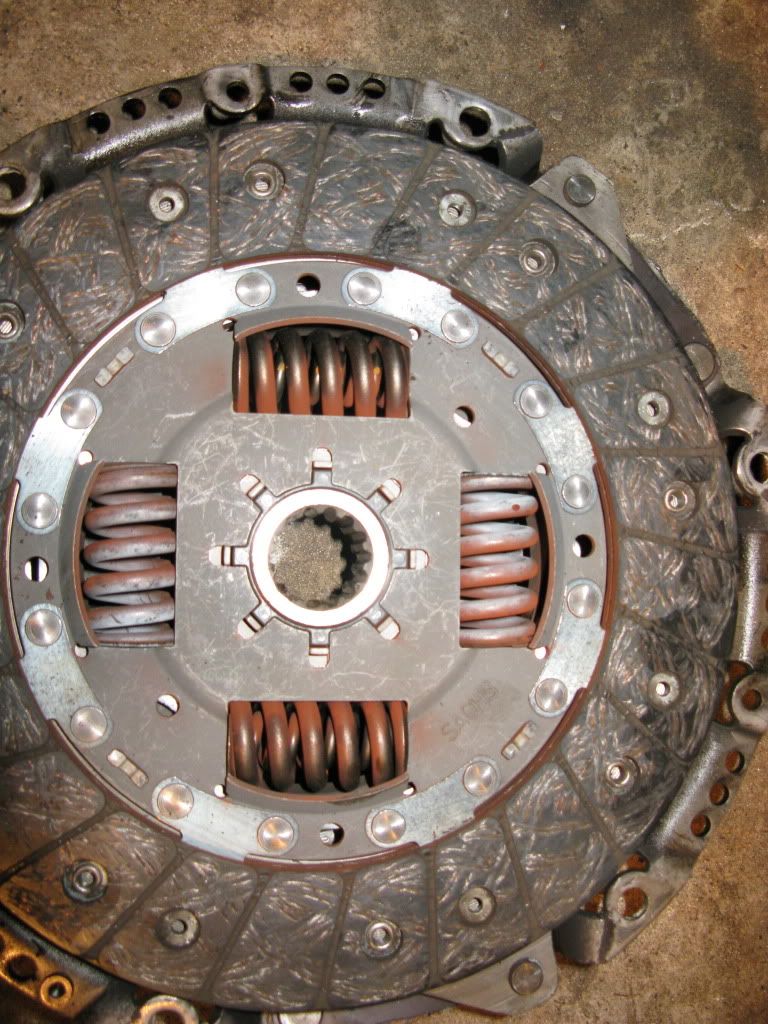

Compare this picture of the "Viggen" clutch coming out of my car:
to what Paul posted.
Certainly looks a little different...can't really tell how the springs look, but all the rivet-looking circles that surround the springs, which are visible on the regular 9-3 clutch, but not on the Viggen one. Now I'm thinking the place I got the Viggen clutch kit from didn't really give me a Viggen clutch kit.
If this is true, the good news is that the clutch was holding the power fine (at least it was for four months so far). But now I have to try and find out if I can get money back from the place I bought the "Viggen" clutch kit from...seems unlikely.
In those eEuro screenshots of the two clutches, one is viewing the 'front' of the disc, and one is viewing the 'back' - flip yours over.
There also might be Sachs part number info, sometimes it's printed (not stamped) near the input spline.

Get a partnumber off the disk....
Hmm. Well i'm leaving in an hour to go pick up the car, and I'll see what the p/n is. So basically, there isn't really a visible difference between the two then? Except maybe the color of the clutch springs?
I'm not sure what to tell the guy at the shop at this point. I hate this stuff.
viggen clutch part# 51 74 933
se clutch part# 51 74 966
viggen pressure plate# 50 23 718
se pressure plate# 53 37 589
The Sachs pressure plate usually only has the Sachs manufacturing stamps on it, like MP 202 or something like that, it may not have the SAAB part numbers anywhere on it, sometimes it's only on the box.
