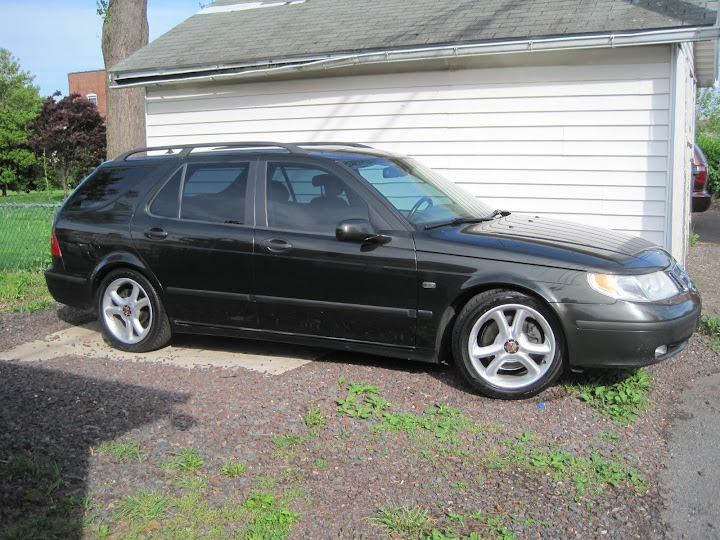

A friend of mine, as well a customer has recently purchased some new tires for his Fondmetal 17" wheels on his 2003 9-5 Aero Wagon. He opted for the upgraded size of 235/45/17 - they they look great! Problem is - now there has been recent rubbing on turns while hitting a bump. Recently the front tires caught a clip in the front wheel liner and bent it downward. I recall 9-3's having these same issues when fitted with 17" or larger wheel and having to "roll" the fenders to correct. Has anyone attempted this on a 9-5? What does the process involve and what is needed to do so.

Tires shown are a 225/45/17

The offset on those Fondmetal wheels IS different from the oem "turbine" wheels he no longer has, but it's also the same offset with the RKII wheels he is having redone in the future - so he needs to get this resolved soon since both wheels he owns have the same offset.
The car still sits on Aero springs (might be getting lowered in the future) and Bilstien HD's all around. Car has 120K

I think the solution is to run 225 tires.
I would tend to agree, however he has just purchased and had installed some 235's. I know I run 235's on our wagon, but on the Aero Turbine wheels - which seems to have less? offset then the two sets of wheels he owns. Again - he has Bilstien HD's on his car and I only have 1 set of adjustable Koni's on the rear set to 2 of 3 firm. Running a 235 on a 9-5 should NOT be a problem - but it seems the offset of those NESA and BBS RK2 rims will not allow it on Aero springs and firm suspension... If rolling fenders are such a costly task, perhaps I'll suggest he tries to sell those NESA wheels and tires off to someone and refurbish those RK2's he want's to do.

Not sure on my friends source of facts - but he seems to think the offset of the current wheels as shown are the same exact as the RK2's - which would mean they too would rub. Anyone have other specs to confirm or dispute otherwise? If they are different and the RK2's would have no rub issues I will light the fuse and tell him to send them out to get re-done.

regardless the car owner should have realized that dependent on tire of choice, going wider has a varying effect on sidewall, as well as again depending on the tire a 235 sidewall effectively "ballooning" because it is on too narrow a wheel i believe the fondmentals are only 7 wide, which winds up giving a 225 and a 235 almost an identical contact patch. if he had looked into it, he would have saved himself by going with a 235/40, if he was set on 235s, or the better choice of 225's.
