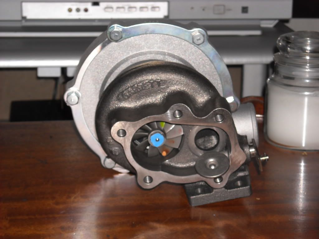

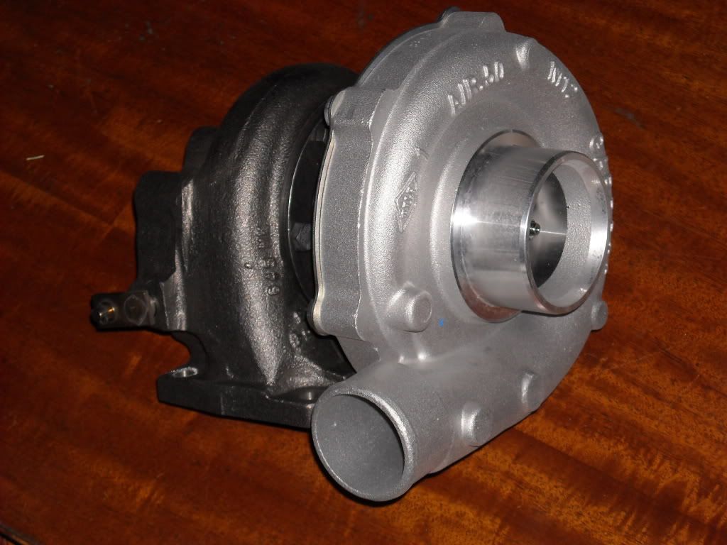

GT3071R arrived today> Im lucky my neighbor signed for me as I was at work when it came. Time for a winter project
I didn't port my gt3071 and I'm not having any noticable problem with boost creep. I'm only pushing max 26 psi. I think if I got the cams and wanted to run more boost, the internal wastegate would be a problem. I think I need beter suspension and an LSD now!
A compressor any bigger would have issues fitting on the OEM manifold. I have a 2.5" turbo to IC pipe and the 2"-2.5" elbow hits the fan shrowd.

All depends which turbine housing he has:
On my 0.64 housing I did a big WG hole porting job as I predicted bad boost creep. I did it about as big as you can get and it blows open above 1.55bar 4krpm at 1bar base boost.
I've cranked up the base boost to 1.2bar and it's happy now.
On the 0.86 housing (which I have sitting in the cupboard), there is less need to port as the housing flows better and the WG isnt needs to flow quite so much.
One thing is that the early housings had a smaller WG hole iirc and would have bad creep so make sure when you read posts on the internet that the WG hole is the same size as the one you have.
Which turbing housing do you have mvadenais?
I polished up the intake throat to the 0.64 turbine too - but I think the effect will be about zero for a lot of effort. Any opinions on this?

I changed my plan on that turbo so many times! 0.64 or 0.86 ... In the end I got 0.64 but have bought the 84 trim 0.86 to give it a test too.
Here are my tips to a happy setup on 0.64
1) Port the WG hole 'a little'. Maybe 0.5mm. Don't overdo it.
2) Set base boost to about 1bar (using foot touching brake method). Check base boost carefully before going to run APC
3) Check the you can overboost spike at 5k rpm. i.e. With WG hose disconnected, let boost push past 1.8bar to prove the WG does not get blown open. There is time to catch the turbo before it spikes as fuel cut is horrid.
With T5 cams and T5 head, the turbo can surge if you let it spool too early so you need a nice map to bring it in smoothly and build to peak boost by about 3500rpm.
If you let the turbo come in too hard you'll wheelspin all over the place anyway.
On a budget, it might be worth throwing in the B202 cams to move the spool up to a touch higher rpm.
I suggest 1.7bar is a 'nice' tune for peak boost. 1.8bar is entertaining but tough on the gearbox.
I'll report back when I try the 0.86 but until you drive it it's hard to quantify the turbo in words. The 0.64 spools earlier than I had expected and actually a touch earlier than a T5 engine can consume the flow.
My current boost is something like this. The turbo manages this and it's working pretty well and no surge here but still early days on the tune and I reckon it could be pushed a fair bit more.
