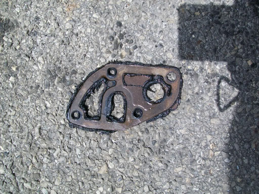

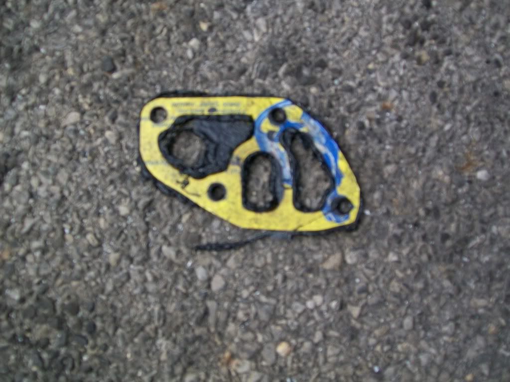

Cardboard "gasket" Monro Muffler Herkimer, NY:

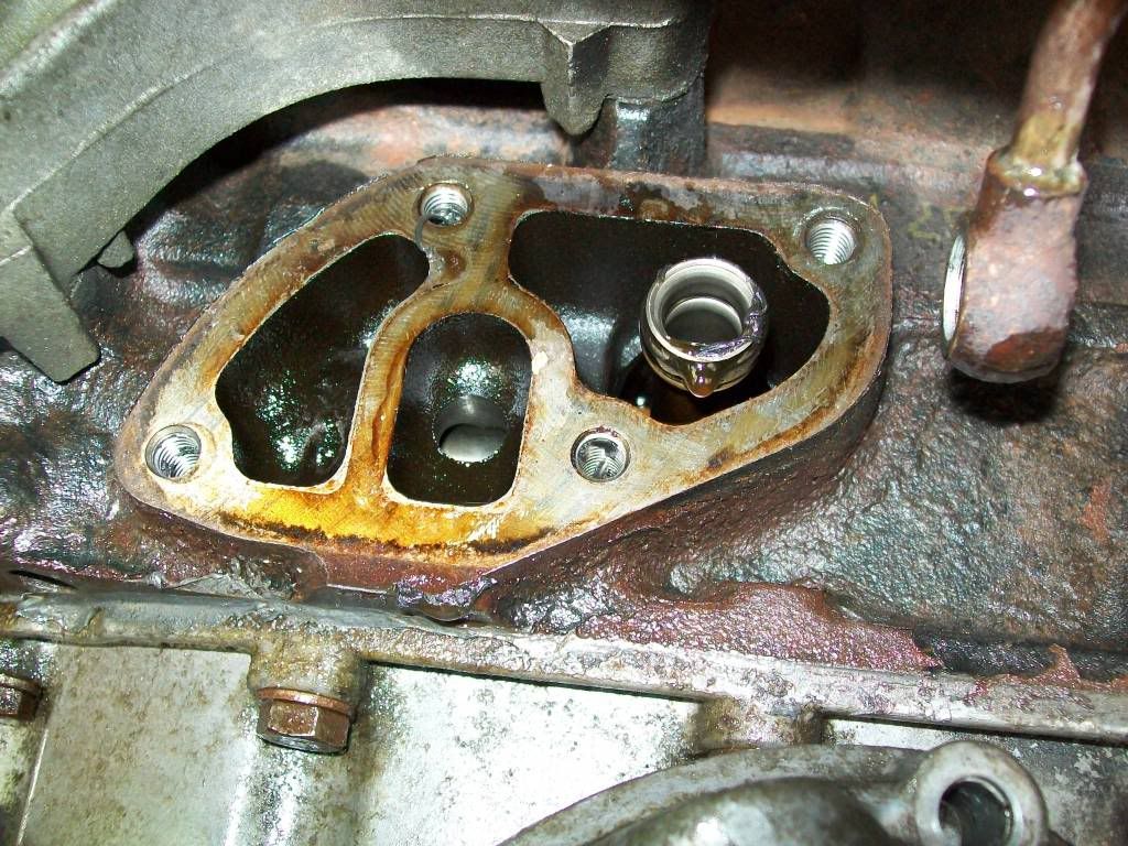

Oil filter housing:
Oil filter housing and lines:

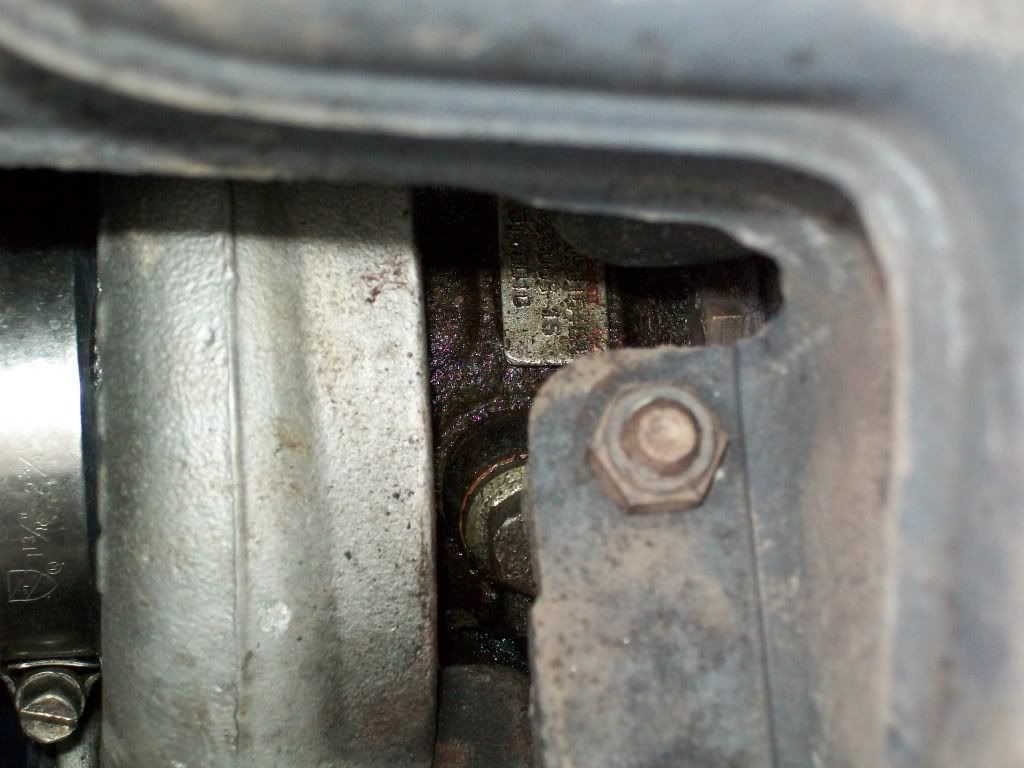

Will take pics of turbo where leak is..but for now the oil is dripping down the line that connects to the oil filter housing..

the oil filter housing should not have a gasket where it bolts up to the block.

Well luckily these pics are old and fixed the oil leak at the turbo bolts. Turns out they were just loose and with some improvisation with a wrench I got it done. I also fixed the exhaust leak at the Dp. I greased up the DI cassette and MAP sensor splice connectors and now it boost strong again. No misfires under boost.
