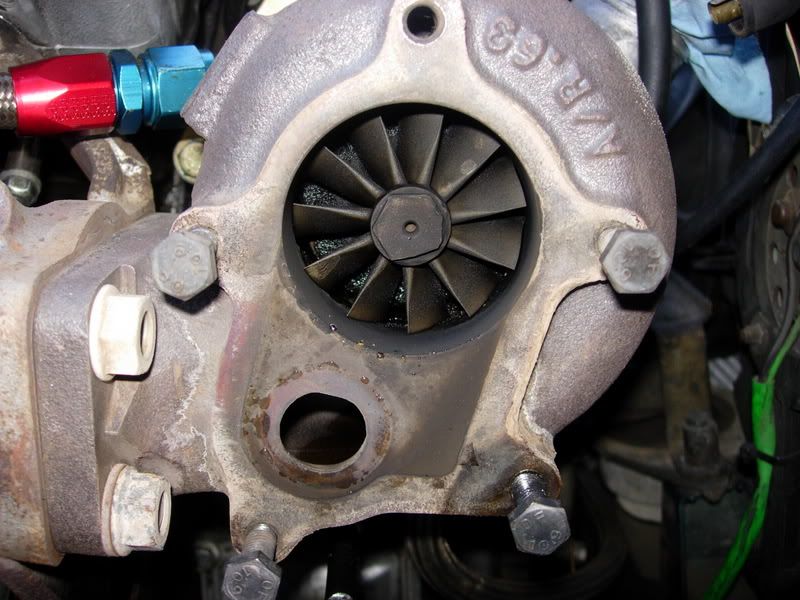

i took a few minutes to start getting stuff out of the way so that i can rebuild my turbo this week (rebuild kit is scheduled to arrive tomorrow, Monday).
i did not yet pull the turbo out, will probably get that done today. i did pull the intake off and that was, surprise!, quite well lubricated with rather fresh 10w30. the exhaust elbow was pulled off after that, then the wastegate housing.
here are some pics of the housing. everything that looks wet, is, well, wet. the oil present here has not burned off only because the car was last started just long enough for me to drive the 20 feet total to get across the street and into the driveway.
