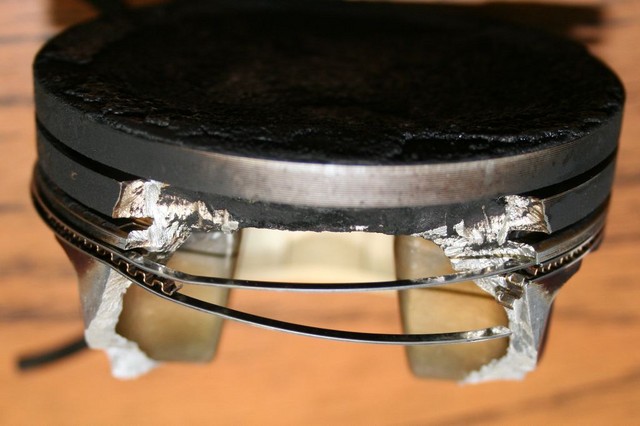

This owner came to me with an oil leak problem for a few days. It had been updated to the newer crank vent at another shop and still had oil leak problems. Suddenly it all got lots worse with billowing clouds out of the exhaust. Near 0 compression on cyl1, You can see from the pics where the piston was broken for a while then finally lost the rest. These are the updated -01 pistons. I figured you guys would be interested in seeing these pics. (Even if it is a little sad) had stage1 soft from another tuner. Still unsure if there was something failed that helped it along or not. It has lots of carbon buildup that would contribute to preignition. We have to get it running before we can test it to be sure it is healthy enough to send home. The other interesting part is that the bore was not as ruined as you would expect. Damaged yes but not horrible. Getting JE pistons.
More here http://genuinesaab.com/gallery/ViggenJCrank
And people give 99' pistons such a bad rap. Basically I think it comes down to the overall health of the subordinate systems and a bit of luck. You can have a stage 3 Vig go on in great health and you can have a bone stocker devour a piston.....its hit or miss.
More reason to love my B234 motor. I know that those pistons are only good upto about 300 hp but theres no way that guy was running that much on stage 1 setup. I'm willing to bet it was a bad piston from the supplier that finally gave, kinda like what happend to me only with rod bearing.

sucks about those pistons though. that just looks harsh.

If I could find a 9-5 with a blown motor for dirt cheap, I'd consider dropping the B234 in there and using T7 with no problem. The main issue I have with T7 cars isn't the engine management, it's the dog shit hardware in the engine itself. Combine a crappy PCV system with a crappy oil pump and crappy pistons, and the result is going to stink, as evidenced by that picture in the first post....

#25 · (Edited)
Some things I forgot to add is that it has been tuned for years with no apparent problems.
My best guess is that due to the huge amounts of carbon buildup that the failure is related to the crank vent system. It had one of the previous fixes and has had blow-by related problems for a while.
Most of the other piston problems we see in these is related to oil starvation or obvious pre-igntion melting and the subsequent galling in the bore. This is the first cracked piston without obvious major cause.

Man I thought my 2.0 looked bad when that rod bearing let loose...I had nothing on this thing!
Hey Nick - could elaborate on these blow by issues...I might be on the phone with you a little later on today - time to order some new toys and ask some more questions.
#30 ·
I wish I kept my old 9-5 engine for investigation. It blew up on the race track two years ago, and the conditions were awfully similar - stage1 from "another" tuner and one of those intermediate PCV fixes (whatever was current in 2004).

#35 ·
and plus, I don't think I have ever seen a check valve in a turbo car that's lasted more than 5 years. boost in the crankcase will blow seals, make the car run rich and possibly cause a host of other issues. If you don't replace the PCV system, at least do the check valve (if you can get it off without it breaking to bits)
