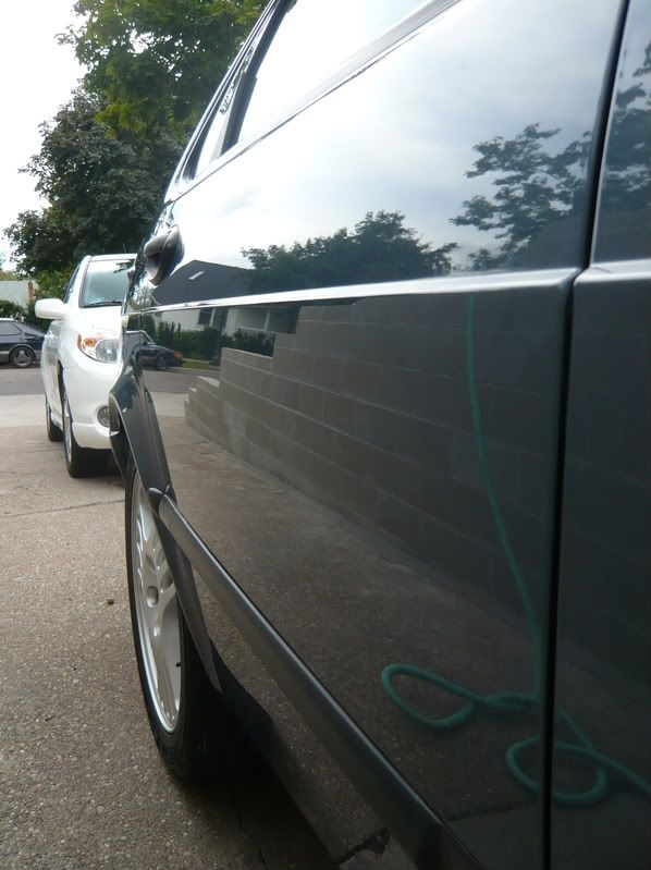

Has anyone put wheel spacers on their 9-5. I have noticed, after driving an m3 around, that the 9-5 wheels are really "hidden" inside the car when looked at from the front. I would like to kick the wheels out a little to give it a little wider stance without buying new wheels and tires. Anyone have opinions?

On my 9-3, the front wheel sits pretty well...5-10mm would be enough to make things look *really* nice. Or you could just leave them. The wheel is almost flush with the fender as is.
On the rear, it's a whole new ball game.
