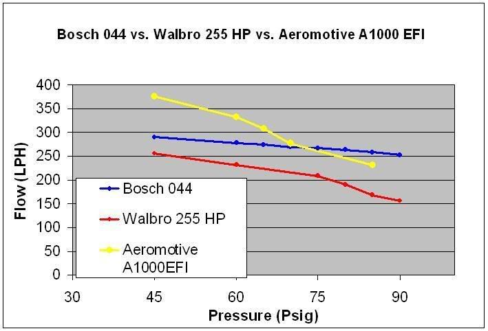

same thing with the pump, i wouldnt waste a step on a walbro. their high pressure/high draw performance does not impress me.
I've already got a walboro 255 pump ready to drop in, what would be a better option?
Then its down to paying $420(ish) for these id injectors or runnin siemens for $200(ish)?
bosch 044
heres why
Where can I source one of those?
just google around, there about as easy to find as the 255's
is this an external inline fuel pump? Or does it mount in the same manor as a stock fuel pump?
it can be fitted in the stock housing just like the walbro
Definitely wish I had gone with a Bosch* to start, now I've got to just add the inline Bosch. They're about twice the price but it's flowing about 50% more at any given pressure. I THINK I was told way back that the Walbro is good to something like 450bhp for us.
