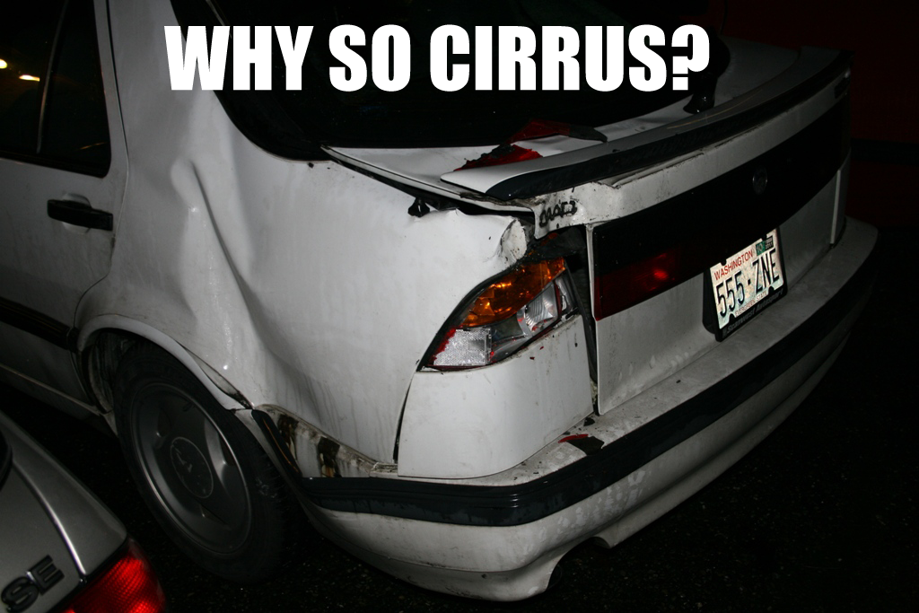

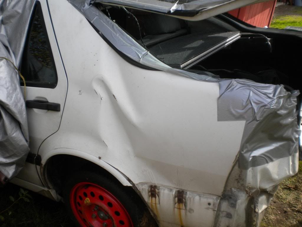

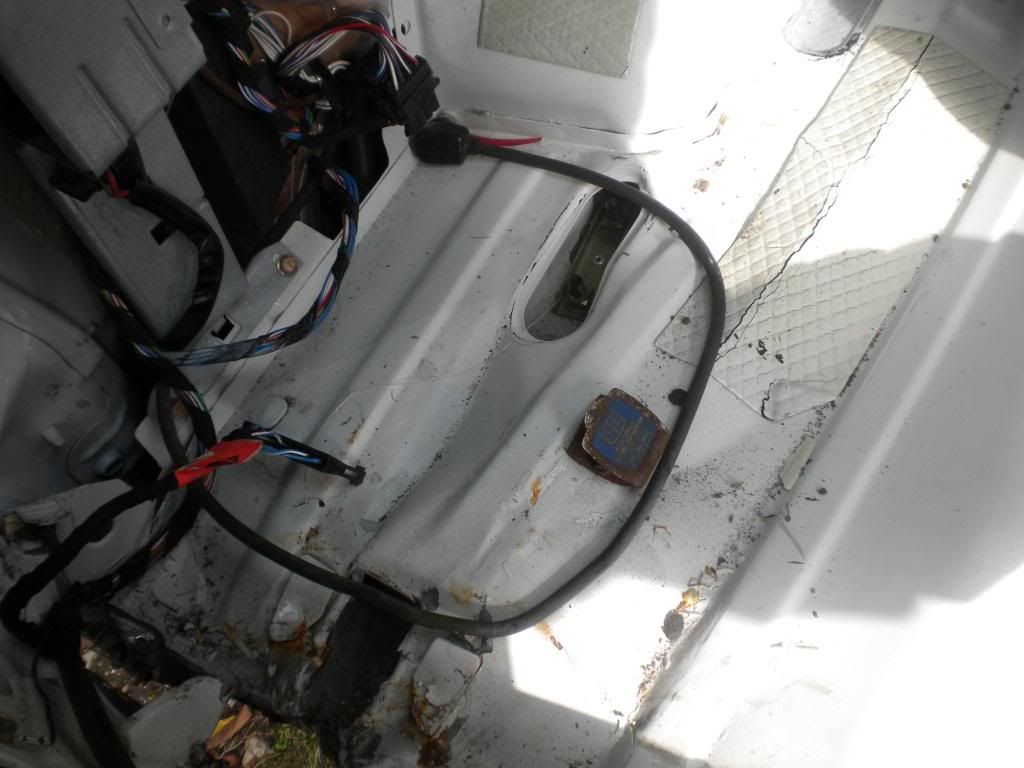

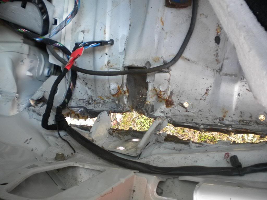

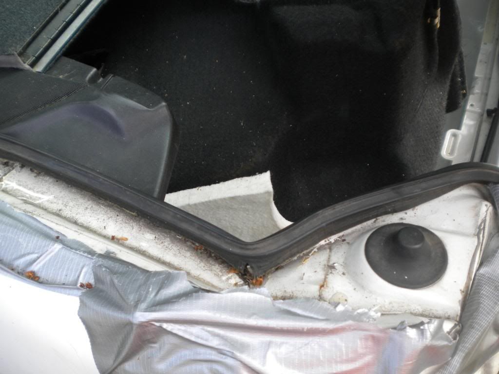

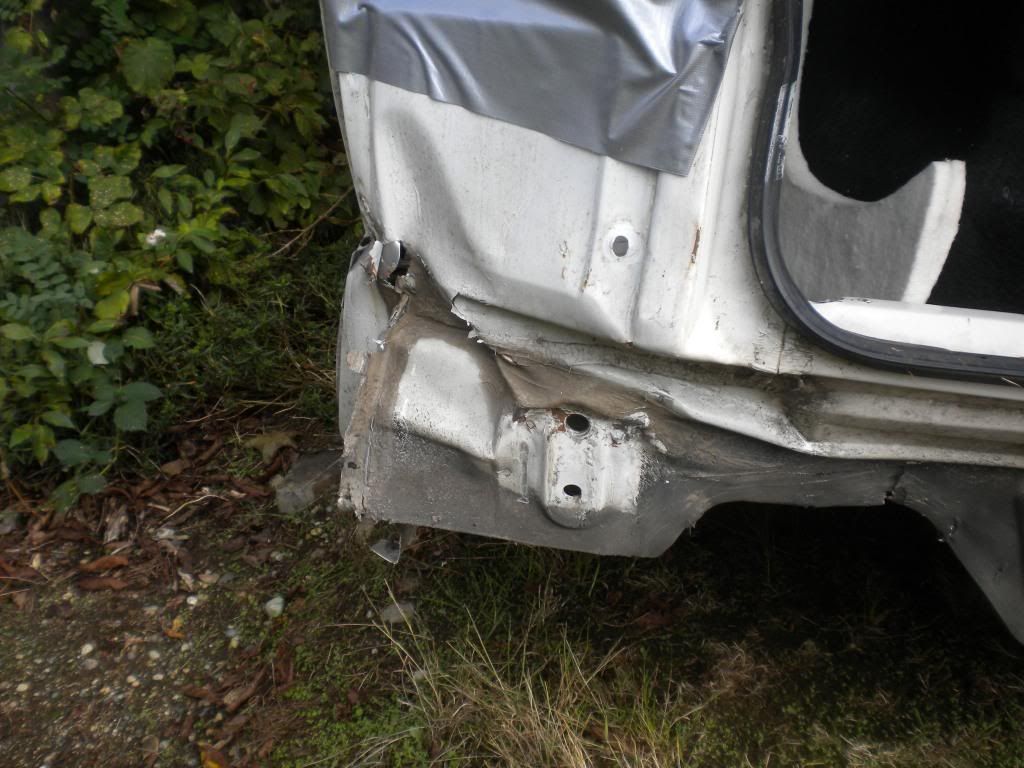

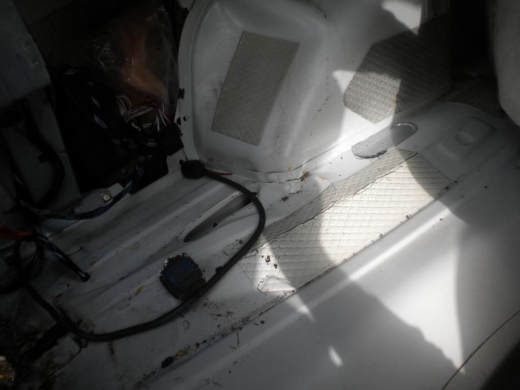

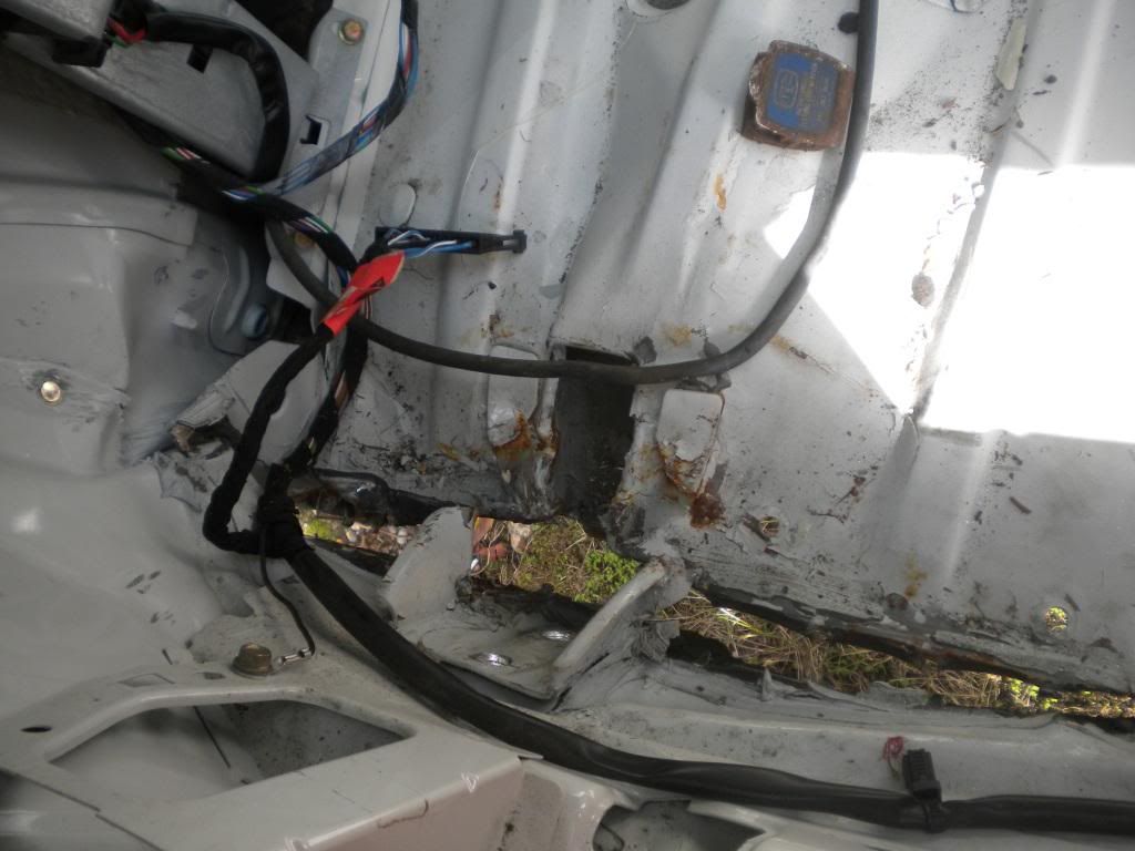

So here are the pics of the damage:
I'll update this thread with pics and stuff as we go along. Interestingly enough, the car's previous-previous owner (kaylan) may have a hand in the rebuild. Watch out.
That does look like a hard hit, for rolling on its own. The bucking on the 1/4 panel looks not a ton different than the hit my car took. Though, it looks as though the tree was a bit more gentle and didn't tear into the metal quite as much as a black ford taurus.

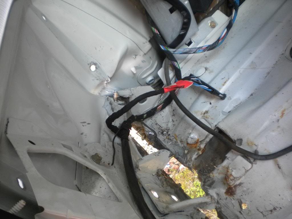

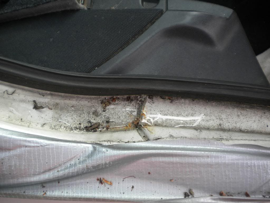

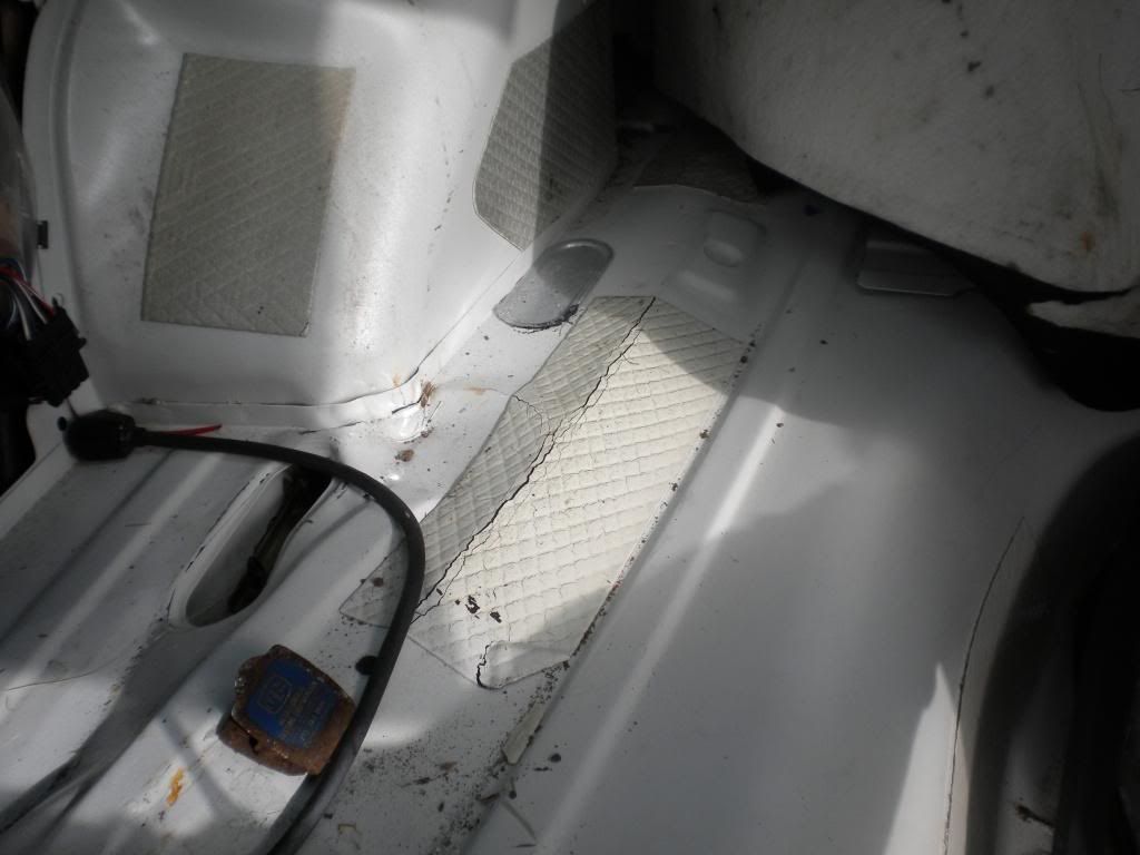

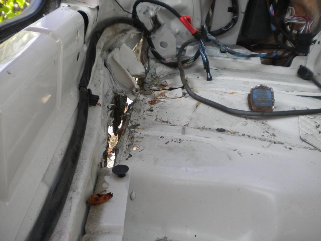

SOAB, we're cutting out all the bent pieces - as you can see in the pics, the taillight area is pretty tragic as well as the floor being buckled. Everything mechanical is looks good (wheel well, shock mount, suspension mounting points, etc) so we're just going to replace the rear quarter + part of the floor.
Sourced a donor car, cutting begins this weekend. I'll make sure to get pictures of the destruction.
