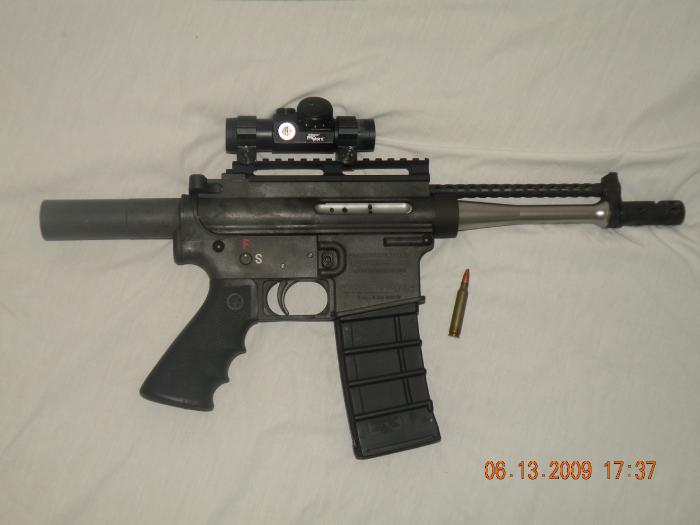

sweet. I think it'd definitely look best with iron sights. I so badly wish I could build an AR pistol. but to be legal in NYS it'd look something like this
it has to be under a certain weight and can not have any kind of a forward grip. so no front hand guard over the barrel.
