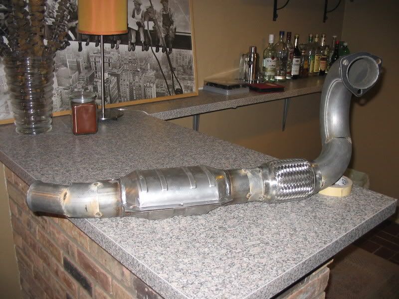

As many of you know I have made some 3" downpipes for a few people in the last few months. I enjoy making them on a small scale so I will continue to sell them to anyone who would like an
The 9-3 downpipe is made to fit either 5 speed or automatic cars, it is designed to mate up to the factory mid-pipe using the factory style clam-shell style clamp.
9-3/ng900 Turbo downpipe - before final welding
affordable way to get their turbo to spool up a bit faster and reduce restriction compared to the stock downpipe.
As of now both 9-3 and 9000 downpipes are made of heavy gauge aluminized steel tubing, and they include a 3" stainless flex section to reduce strain on the exhaust system.
I have made quite a few 9000 downpipes and have updated my design and have finally settled on a good design that is relatively easy to install and will either reduce down and clamp over the OEM exhaust or can be mated to a 3" system, the 9000T includes enough tubing to eliminate the generally weak factory flex section.
9000T downpipe (flex section not shown)
9000T downpipe (cat-less w/ flex section and reducer for slipping over stock tubing)
Either downpipe can be had without a catalytic converter or with one depending on your needs, the basic cat that I will use is a high flow ceramic core Magnaflow unit, the buyer can choose from any number of higher end cats for the additional cost of the cat they choose.
Either 9000 or 9-3 downpipes can be had with more O2 bungs or any other options for whatever the cost of those options may be (this would be determined on a per-order basis).

The only thing I don't like about the 9000 DP with cat is the location of the CAT - it's not a stock location and could cause an early 9-5 like sludge issue with heat to the oil pan.... My cat is BEHIND the downpipe in the stock location and I feel that's a more ideal spot being it's where it's supposed to sit. Not bashing the work by anymeans - just pointing out an observation and opinion. Easy way around this is the cat-free DP :) Nice work man! I'll work on getting you a ng900 customer.
...and actually on the JT downpipe the cat sits about 10-12" farther back then the stock location. More under the floor of the car, then toward the back of the engine bay like the stock downpipe/cat.
#6 · (Edited)
I can arrange the exhaust pretty much any way you want it....I have a 9-3, so making a more complex midpipe setup or whatnot wouldn't be a problem, I would just need some reallys specific info on your needs.
As far as the location of the cat on the 9000 DP I can put it anywhere you want. The on in that photo was made for someone who wanted it in the stock location, and it is in EXACTLY the stock location for a 1993 and newer 9000. I could put them past the subframe if needed as well (ie 1986-1992 stock location).
here is a photo of a stock pipe from a 1995 9000, my first downpipe (still on my car) and the downpipe pictured in the post above...just for comparision
