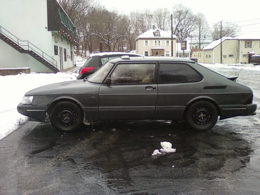

To really do my part in discouraging you from steelie's here's a quick comparison.
My spg this winter on steel wheels...
and stock spg wheels
vs. My spg this summer on 17" bbs replicas
-Justin
