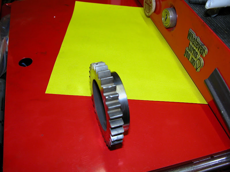

So, in preparation for my little drive in the Canadian north woods this summer, I'm starting this thread to help document as well as troubleshoot some of the crazier things involved with owning/repairing/maintaining Li'l Red, the 1992 c900 base.
Here's the steering wiggle issue (upper steering bearing throwout)
Steering column wiggle
The low-end miss (spark plug wires)
Low end miss (B212)

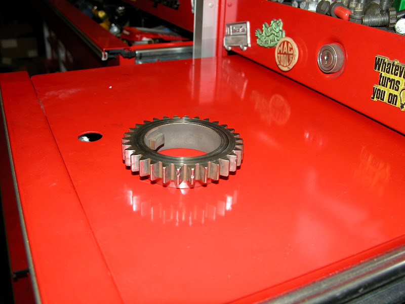

And now...notched oil pump gears?!?!?
The good news? The oil light has never come on and, between Greg Abbott and I, the car has gone from Minneapolis to New London, Conn.
The even better news? Very little in the way of metal shavings in the oil upon the oil change this afternoon.
But, still, damn. What could have caused this?

something got in there, why was the oil pump out of the car? Was this to correct an issue with the front main seal /oil pump O-ring/ crank pulley? More than likely some foreign object got sucked into the oil pump and smashed... who knows what, but the oil pump draws in oil before the oil filter so what ever it was was probably safely filtered out.

I would imagine the plan is to pop a new or good used set of pump gears in there. They are pretty rarely an issue with C-900's and if they are, it was either a very odd fluke, or you have got bigger problems than just the oil pump.
Oh, also as for as the crank sensor. We have a unit we rigged up that will bypass it and run the car off of a distributor hall sensor if a failure should occur. The CPS is something that could kill the car, takes hours and hours to change without a lift + a special tool... the rig basically takes the CPS out of the loop so it's not needed and will allow the car to run on a conventional hall sensor distributor.

The plan for now — based on the fact that the oil light hasn't come on in roughly 1,500 miles (many of which were really, really hard and hot) and there doesn't appear to be an alarming amount of metal in the oil — is to put it back together and eventually, pre-trip, do the gears. They're about $107 OEM new through thesaabsite but I haven't checked with my local indy foreign car parts place yet.
The oil pump was off of her to remedy the O-ring seepage issue. I took Li'l Red over to my mechanic's place to have him take a good look at the engine mounts and one thing led to another. He was actually just about to throw out a perfectly good c900 upper steering column so I cut a deal on him putting that into the car and fixing the O-ring issue.
I'm going over there this morning to do the skidplate and front and right side engine mounts in his nice, warm indoor garage. That should make her road-worthy again.

it's far easier to take care of the oil pump now, rather than having to take it apart again later...
yeah, I got to say I agree there. it is a PITA to remove

Agreed, but the car was eating up the work bay at the mechanic's house and the problem was discovered too late Saturday for any of the parts houses that might carry the gear to be open.
